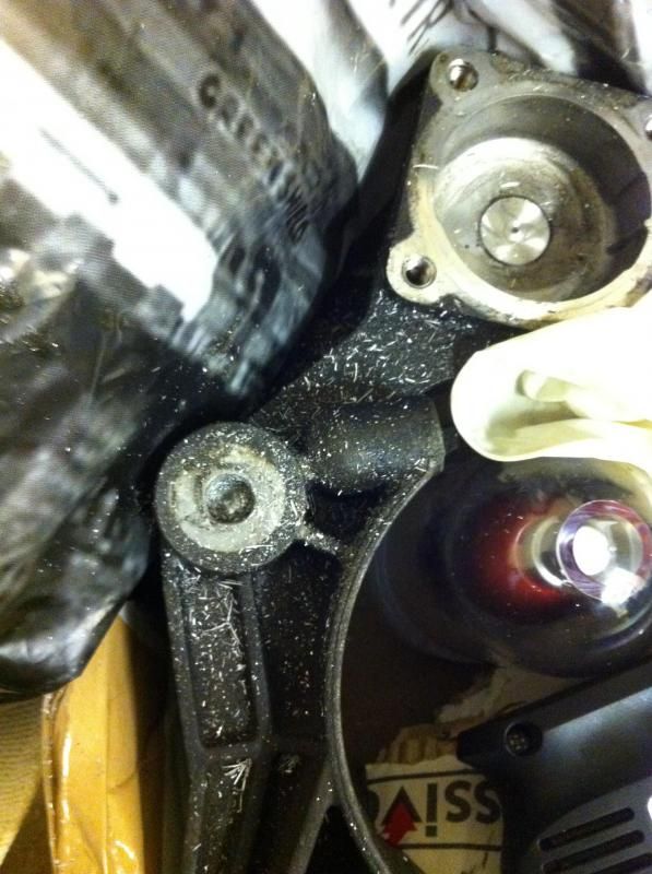

Any idea how I might get this bolt remains out?
Powerful mains drill and new drill bits it's won't hardly scratch it!!
Do we have anyone on the forum with the kit to helicoil it, who I could perhaps post it to in return for suitable beer funds?
Advice much appreciated :y

Cobalt drill? They're harder than a normal HSS twist drill  :-\
What size is it? I can lend you the stuff for a Thread Cert (arguably better than a Helicoil)

little to late i guess,I always use left handed drill bit to remove broken bolts studs etc often find they actually unscrew the remains whilst drilling it!

James, I don't want to teach you to suck eggs, but are you trying to drill the whole 10mm in one go? That rarely works without a lot of power which you won't get from a hand-held drill. Have you tried it in stages; say 4mm(being careful not to break the bit), 7mm and then 10.
The quality of the bits makes a difference too. Getting good, branded ones from your local engineers supplier could really help.

Couldn't get another bracket anywhere it's a very large item
Machine shop have sorted it, ready for collection £20 :y

Have they just removed the remnants or used an insert or helicoil to restore the thread?

It's been helicoiled, seems fine.
Apart from the fact the air con pump feels a little dry to turn (it spins smoothly) I can't find any reason for this bolt breaking. Tensioner and all ancillaries spin fine and tensioner is ok.

Might not hurt to replace the bearing in the tensioner pulley, might get hot and stick slightly, and if you were giving it large when it broke...
Have killed a water pump on a car by finding second instead of fourth ::)
