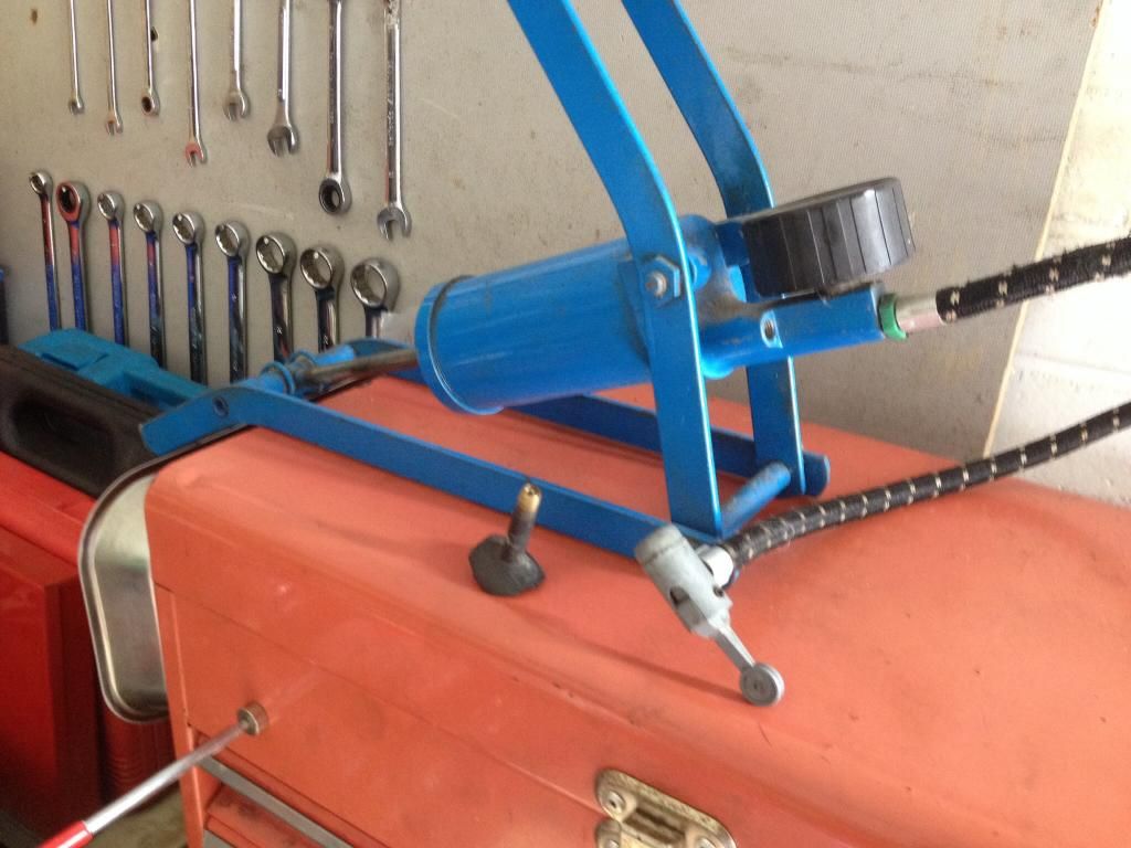

....is this going to work, really?
It's a foot pump with the end clamped to an old bike tyre valve and then jubilee clipped in place inserted in the coolant hose (to plenum)?
i think it was nick and cvhris that suggested this... and in no way doubting you but will the pressure bot simply escape past the jubilee clip?  :-\
if youre confused as to my description (i confuse myself easily enough) ill get a pic up tonight! :)

Now I'm confused, as I would buy a cheap mountain-bike inner tube and cut it opposite the valve. Fit that instead of the most convenient radiator hose, and retain it with Jubilee clips. Add about 20psi pressure, and leave for a while. If the pressure holds, the system is good. This works for radiators that aren't in the car. You inflate bike tyres to 100psi, so the pressure isn't a problem for the valve!
Yeah thats what ive done :)

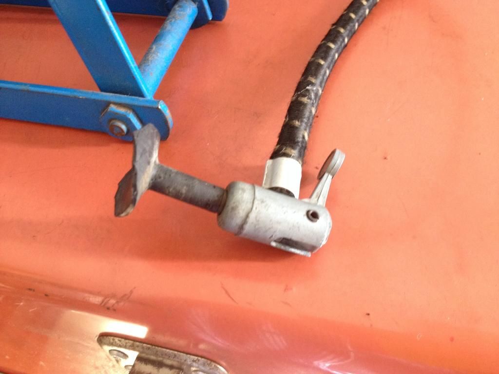

This has then been attached to my foot pump by the foot pumps clamp.
then shove that in the coolant line and small jubilee clip... job done.
thanks for confirming that nick :)
should the pressure hold for a long time?

I was gonna make that as I do have a spare cap but just too much hassle.
This is my alternative...
Obviously I'll need to trim the edges to fit in the coolant hose but then I simply put a jubilee clip round it and then done.
Good?
