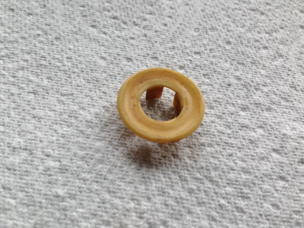

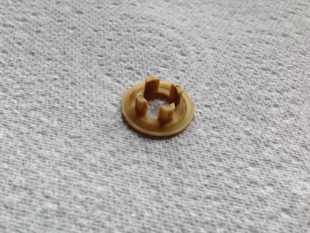

« Reply #7 on: 12 August 2014, 19:54:10 »
Okay I removed this from the drivers door.. How does it look to you guys ?

« Reply #8 on: 12 August 2014, 20:00:46 »
Just replace it, grease the whole lot up and refit and tighten up (tighter than you might think) the nut and bolt assembly.
The plastic washers look fine when you take them off but regardless a new one fixes the problem.... unless the check strap is ripped from the A post or out of the door of course!

« Reply #9 on: 12 August 2014, 20:03:44 »
Yeah i'll get a few new ones especially for pennies, Just to confirm is this the part number 90462823... Unless i use a part number they can never find the part i need most of the time..

« Reply #10 on: 12 August 2014, 20:10:38 »
If its a loud cracking noise, that's the most likely part. About 40p each now IIRC.  You should see movement in it when opening door slowly, esp when it hits the first notch.
Fit dry.
If that doesn't resolve it, it could be the mech in the door.
Don't leave it, as eventually it appears to either knacker the door (fix kit available) or rip the bit off the A post (awkward welding to fix)
Yeah to both of those, Also there is movement there.
