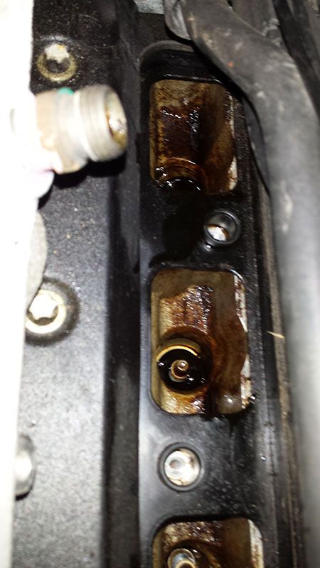

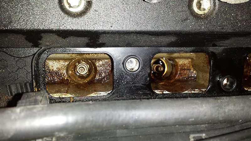

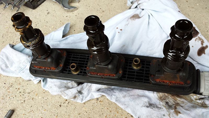

Re: Misfire Y32SE
« Reply #9 on: 16 August 2014, 16:31:04 »
[/URL]
[/URL]
[/URL]
Arse biscuits  >:(
Breather pipes all appear to be clear so why is the cam case pressurising to this extent?  ???
Water coming from the scuttle tray?  :-\

Oil and water. You need to seal the scuttle as well. Hose on the windscreen will show you where its leaking.
I'll give it a whirl. Judging by how clean the engine bay is it might be jetwash related damage from the previous muppet owner  :(

« Reply #13 on: 16 August 2014, 18:02:11 »
How many miles?
Camcover gaskets and coil packs could almost be considered service items after 120k...
71k. Although judging by the colour of the treacle oil , it hasn't exactly been well loved for the last 20k.  :-\
I still don't quite understand why so much oil is escaping the cam covers, (to the point that all the torx bolts have a light misting of oil around them), if the breathers aren't even slightly blocked?  ???
I don't want to go to the time and expense of replacing the cam cover gaskets only for it to go again because it's pressurising for some reason.
