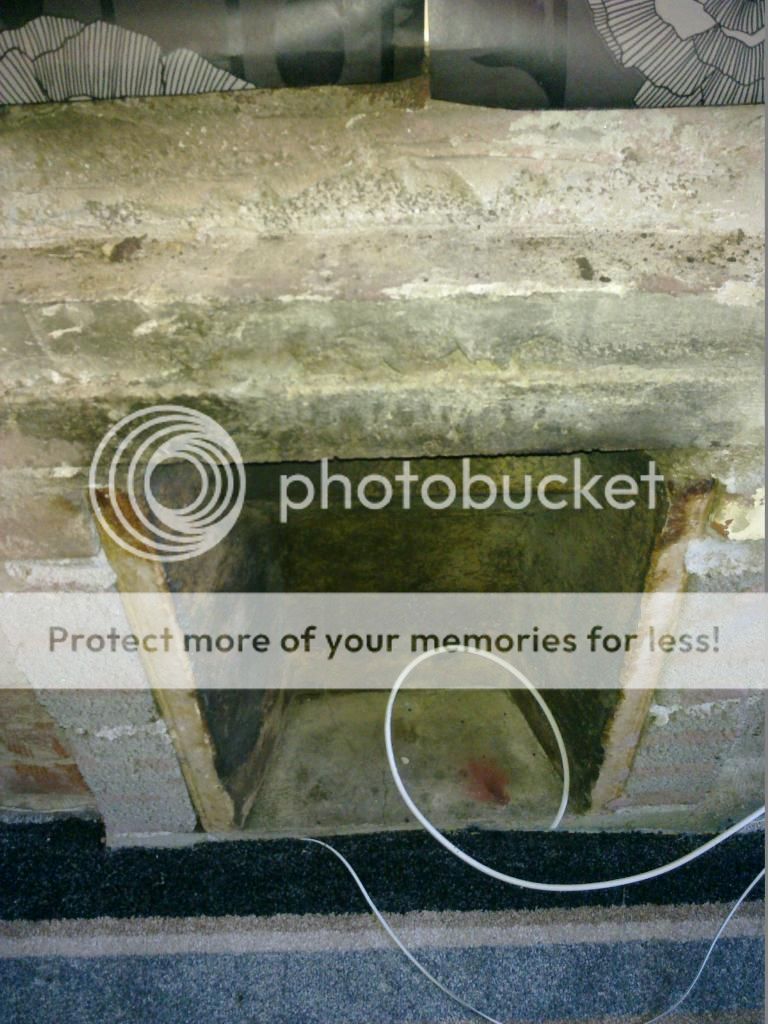

« Reply #4 on: 09 October 2014, 10:56:29 »
This is what is there at the moment.

Re: Wood burning stoves
« Reply #5 on: 09 October 2014, 11:19:11 »
Thanks very much for the advice. :y
Are there stoves about that burn other fuels? Do they all need to be fitted with a flue or would a chimney suffice? Do you need a qualified person to fit a stove? Do they cost a lot to run?
Depends where they're to be installed, unlike the old days you cant just throw them in somewhere and hope for the best, theres all sorts of H&S issues, Building Regs, Smokeless Zones, Local Authority Permissions, Certification etc.
Best place to start is with your Local Authority and see what there rules are or find an Aproved Local Installer who knows the score.  ;)
« Reply #7 on: 09 October 2014, 12:25:57 »
Looking at that, get the chimney swept first off. This will ensure it's ready and not been capped off... especially given that there was a gas fire there before :-\
Then all you need is a suitably sized victorian style grate, and a fire guard and you're away with a nice little open fire on which you can burn logs and/or coal or peat 8)
Perfect for making toast and boiling a kettle when the power goes off :y
Oh and you'll need to trim the carpet to allow space for a hearth, big door step type slab to stand the fire grate on...

cleggy
« Reply #8 on: 09 October 2014, 12:37:20 »
That was my thought, we have a cast iron Victorian surround, but use a gas coal effect grate. Do think about changing it to burn logs, it would be nice if was easy to switch one to the other, say logs at the weekend and coal effect during the week. :y

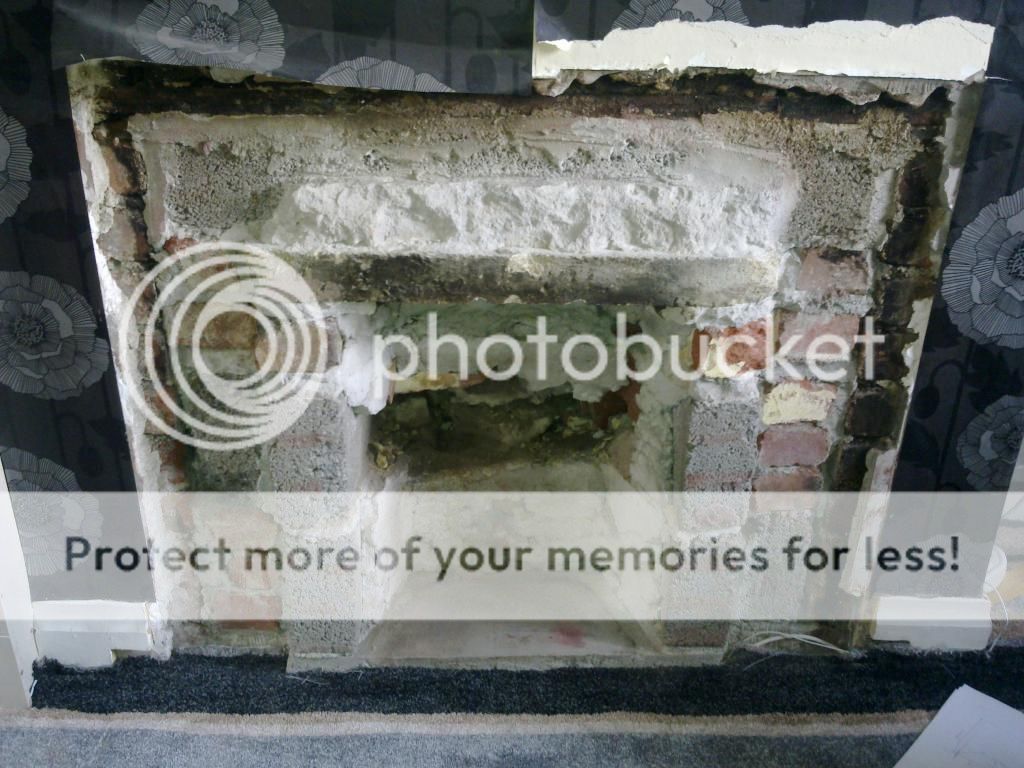

« Reply #10 on: 09 October 2014, 14:21:14 »
I was thinking about getting a cast iron insert until I've got the money for a stove. I tried getting a fire grate but the way the fire back was installed, non would fit. The depth was only six and a half inches.
Today my housemate and I decided to remove the fire back to see what we would be able to install. I'll put a picture up of our progress.
« Reply #11 on: 09 October 2014, 15:11:58 »
This is what I've got now.
« Reply #12 on: 09 October 2014, 15:19:43 »
A backward step me thinks :-\
The fire place was perfect for a modest fire, but fitting a stove in that space will either mean a stupidly small one, limiting fuel choice, or making the fire place alot bigger, (which means structural work...) :-\
« Reply #13 on: 09 October 2014, 16:26:16 »
I don't mind a bit of brickwork. The original lintel is still there. When the fire back was in it was useless as no fire grate would fit. Now it's bigger I should be able to fit a cast iron combination fireplace.
cleggy
« Reply #14 on: 09 October 2014, 16:32:29 »
What size is the hole? If I remember correctly 16 inch is the standard size , less for the bedroom type of grate.
