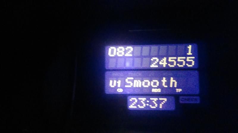

Mid  might be configured to a different model... press and hold both buttons on the stalk... screen will show a whole load of numbers...
That's the config info. Someone will be able to decipher it if you post the details here... :y

Aye that's them :y
You might need to wait for Kevin Wood or Jimbob to see them as the blue leds might be a bit gay for TB :D

That's just my poor quality camera. Makes it look blue lol.   :y

2.6 v6, non 16" wheels, xenon lights.
Does that match your car?

Thats the one.  :)
