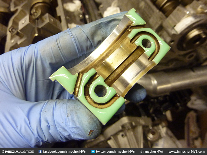

humbucker

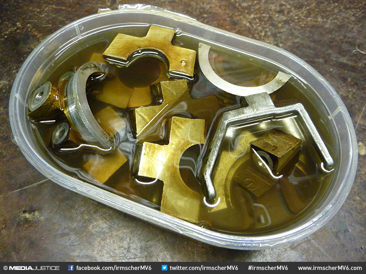

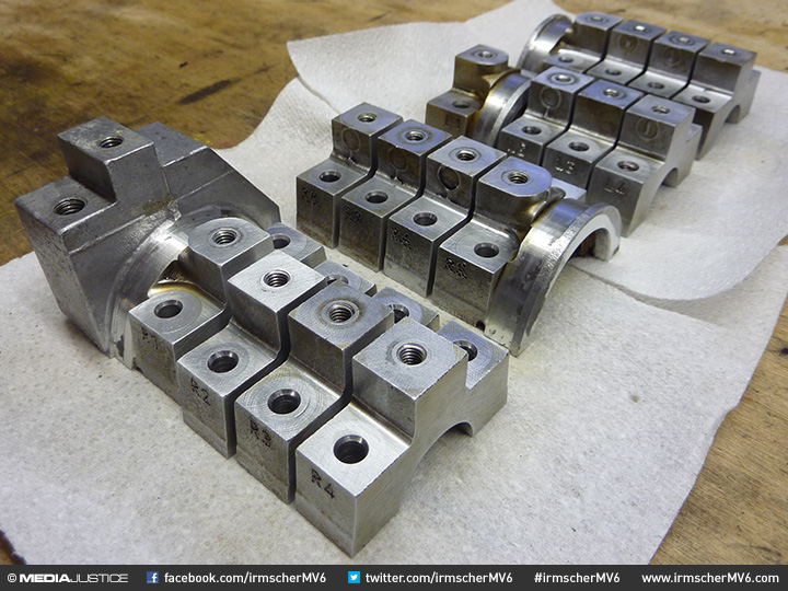

Cam caps were left to soak before being cleaned.

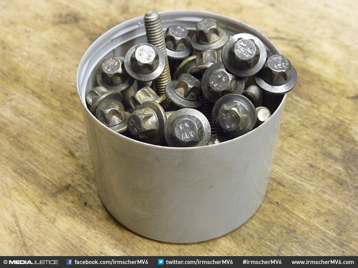

Cam cap bolts were given the same treatment:
Hulk juice:

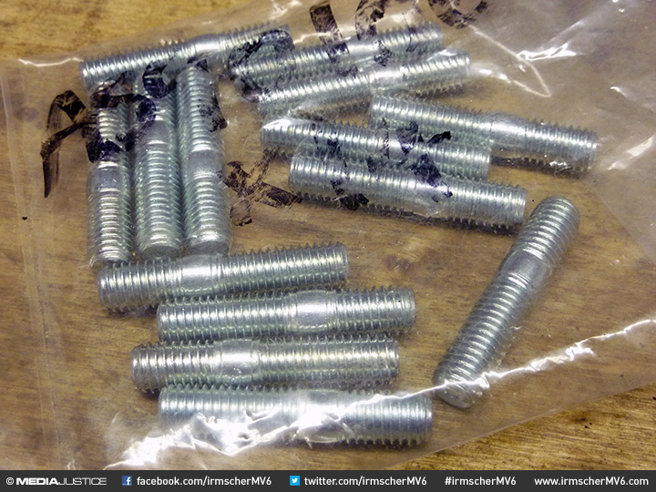

New exhaust manifold studs:

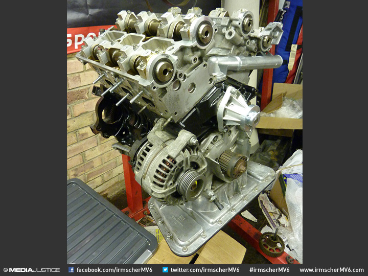

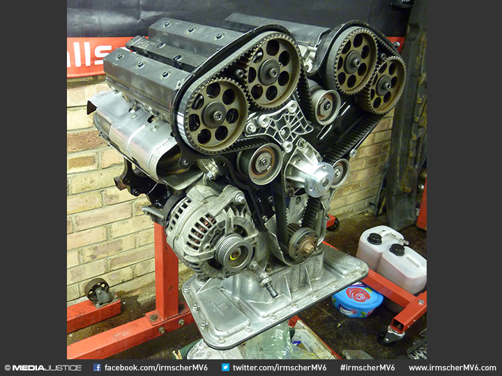

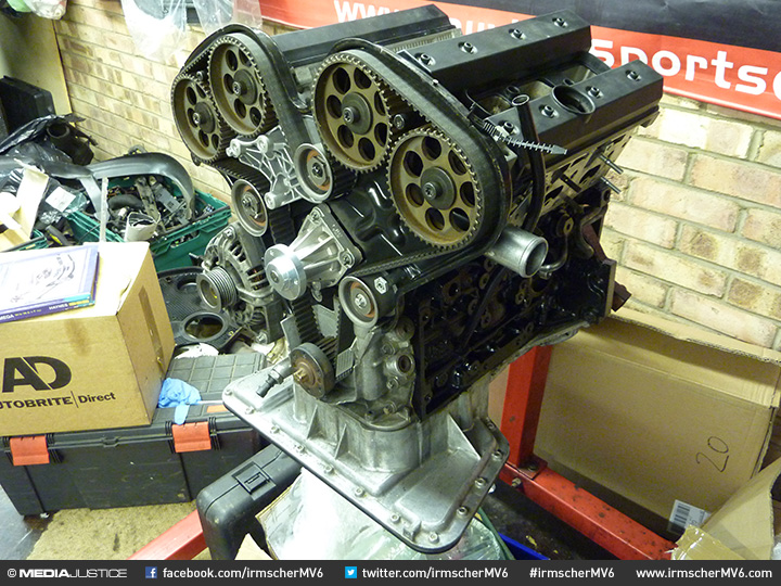

G cams, cam seals, cam caps, cleaned alternator, exhaust studs, new water pump, new 'stat and new coolant transfer pipe in place:

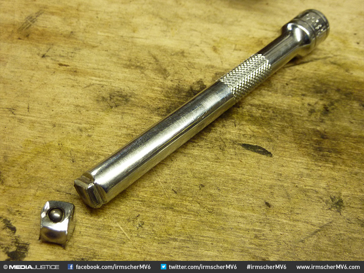

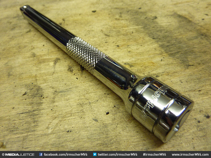

More breakage!
Gawd bless the lifetime guarantee that Halfords applies to its tools!

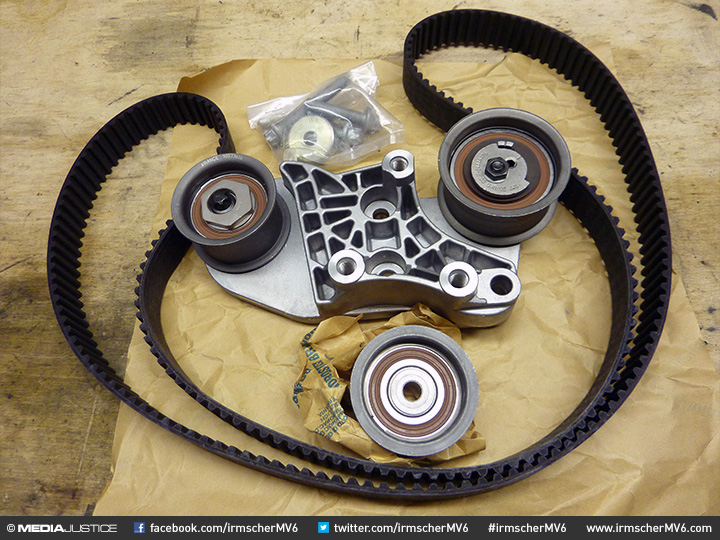

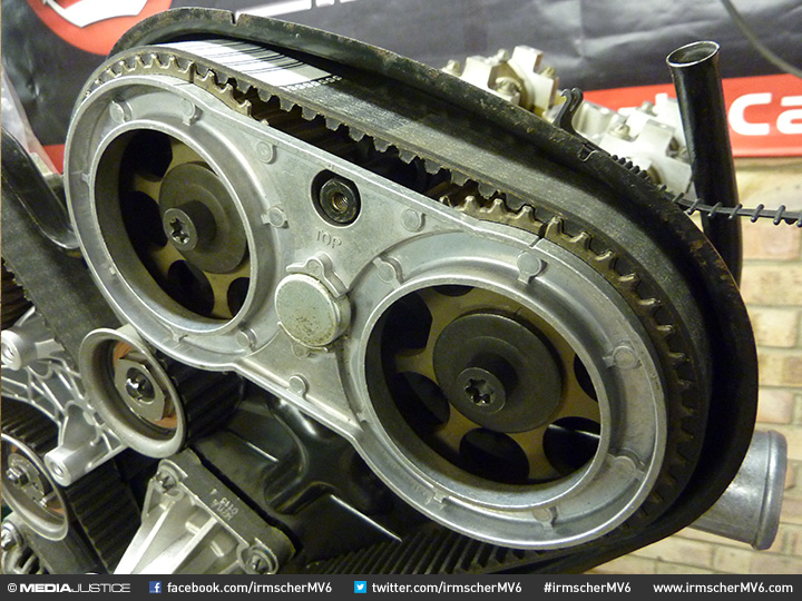

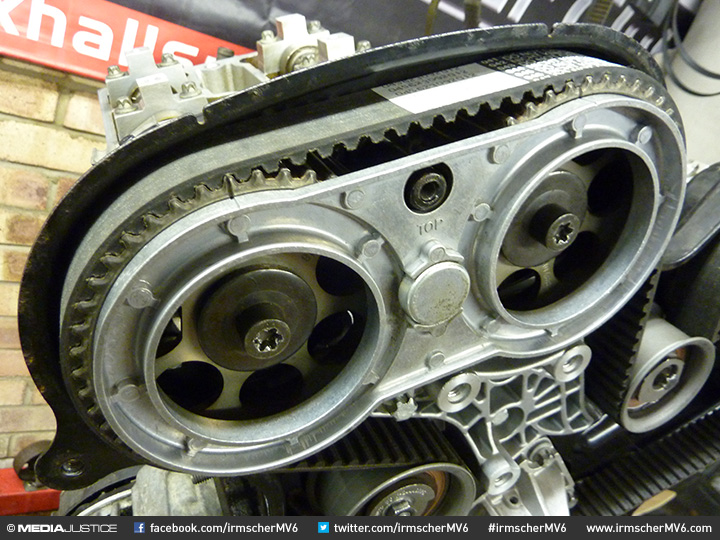

New genuine GM timing kit. Let the fun and games begin...   >:(
Success, but only after what seemed like a zillion attempts at getting each and every timing mark lined up correctly. Thanks must go to Serek for providing me with reassurance when I contacted him for a sanity check!

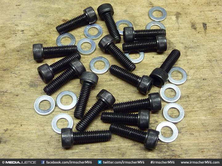

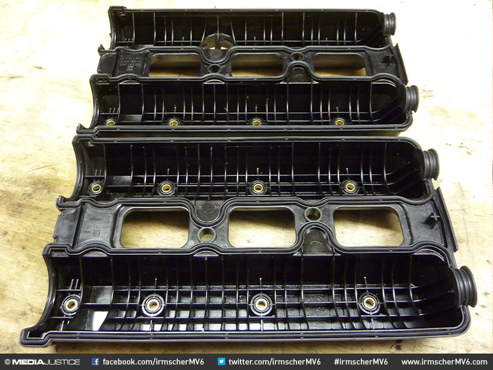

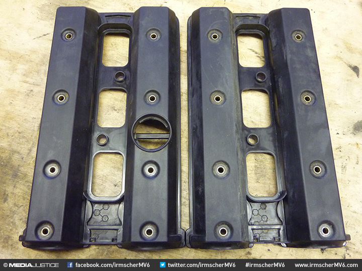

The car's previous owner bought brand new cam covers direct from Vauxhall shortly before he sold up in favour of a new Insignia. Time to give 'em a clean before fitting all new gaskets.
The original cam cover bolts were a beyond their best. I bought replacements in the form of nifty caphead bolts and matching washers.
Hey presto!

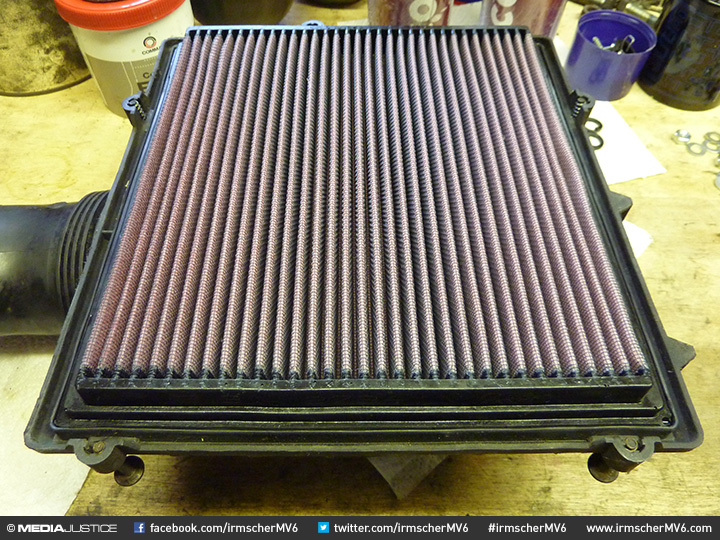

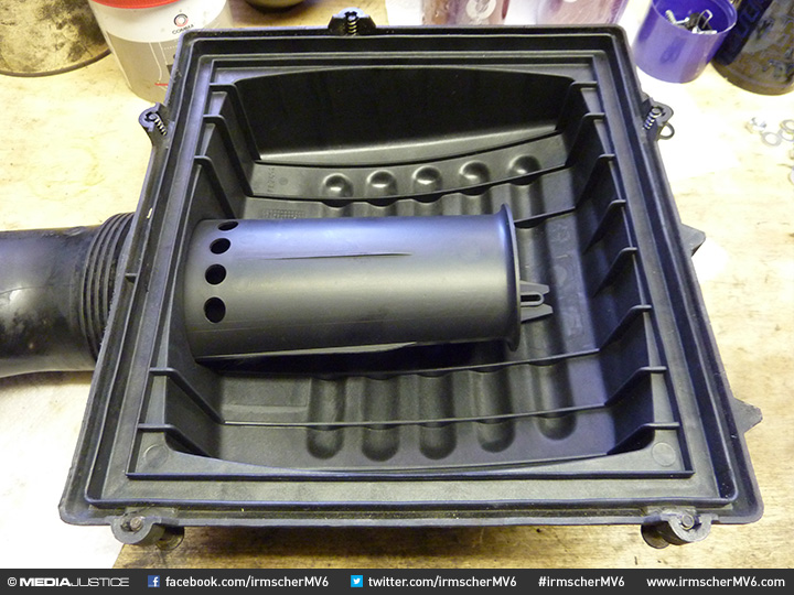

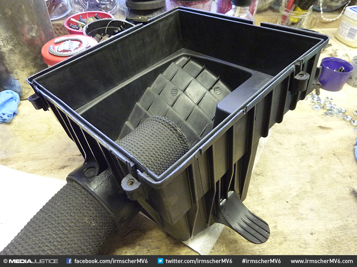

Airbox opened up, cleaned and equipped with a new K&N panel filter.

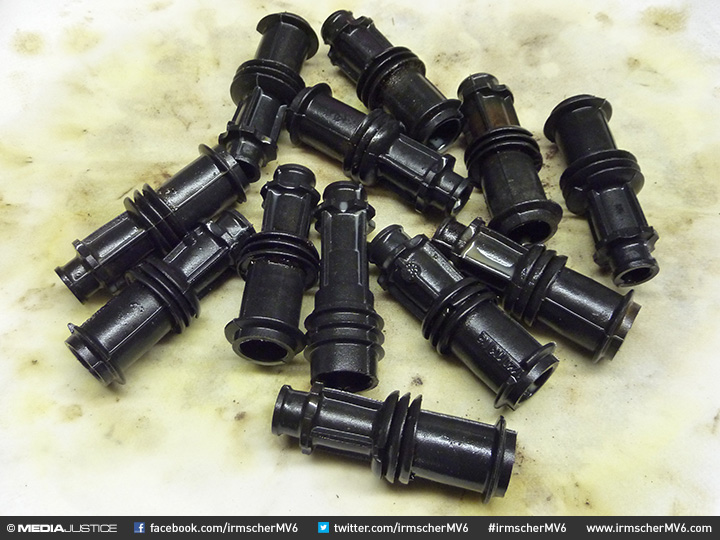

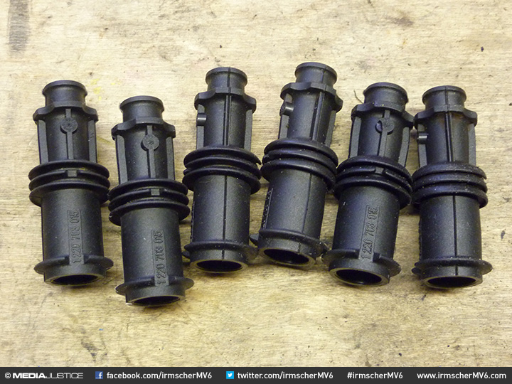

The coil pack rubber sleeves (or whatever you want to call them) were bit grubby. Degreaser at the ready!
Nicely done:

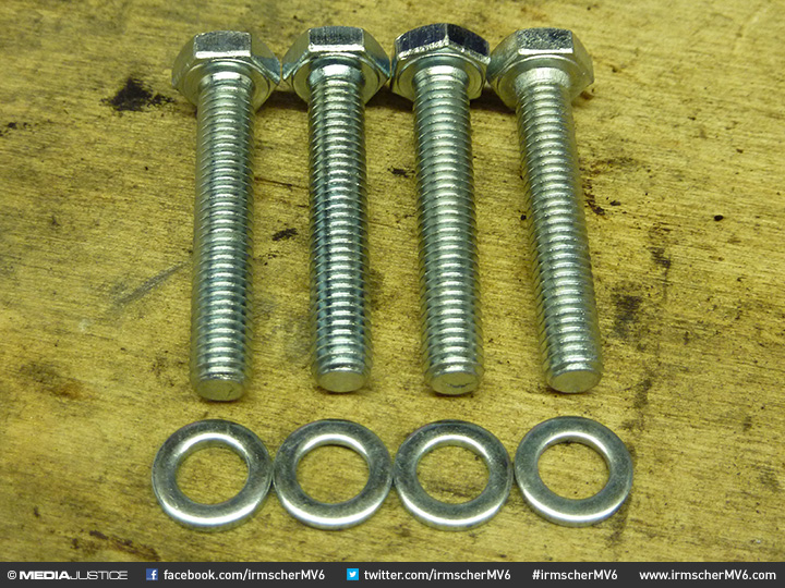

New zinc-plated bolts and washers for the coil packs:

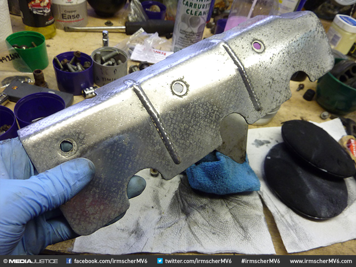

The donor engine's exhaust manifold heat shields were really filthy. I scrubbed them with a sponge and degreaser before testing some Autobrite Direct 'Metalworx' polish to see if the parts could be restored in any way. There isn't much that can be done about the pitting in the metal, but the heat shields are now a lot brighter than they were before I started playing with them. They would probably look even better if I'd had more time to spare. Meh!
I also fitted all new exhaust manifold nuts and cleaned the heat shield bolts before installation:

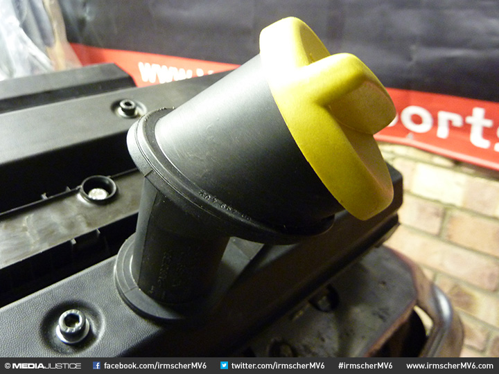

Oil filler neck and cap spruced up and fitted:

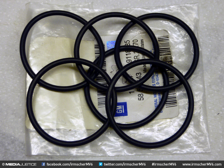

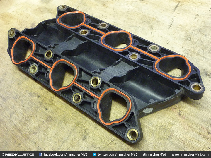

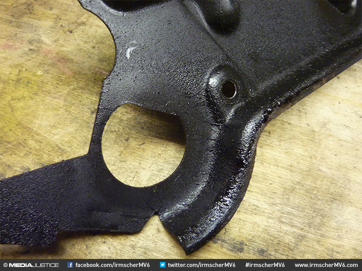

Time to sort the lower inlet fanimolds and fuel rail. Lower induction flange cleaned and treated to new gaskets (both sides):

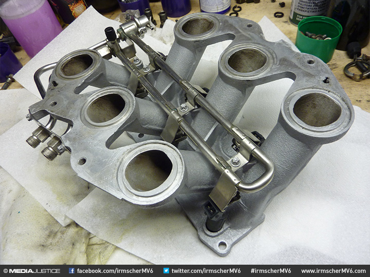

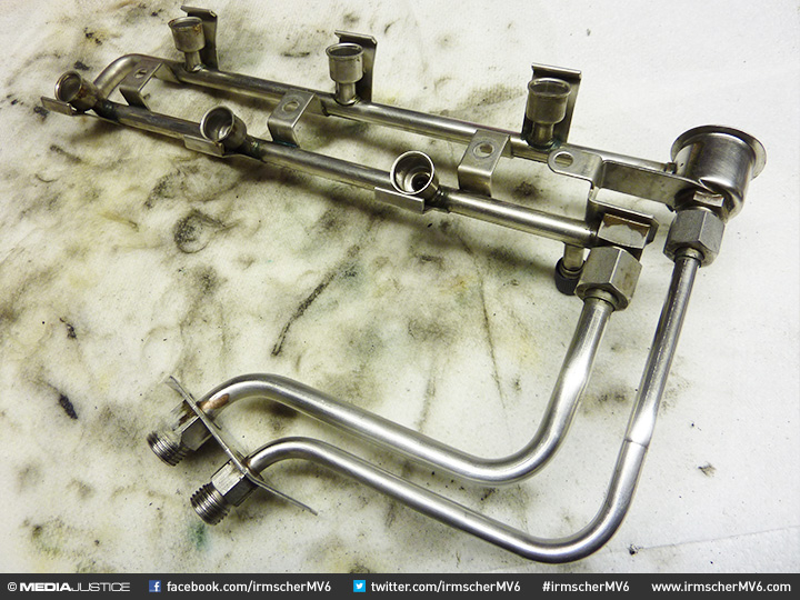

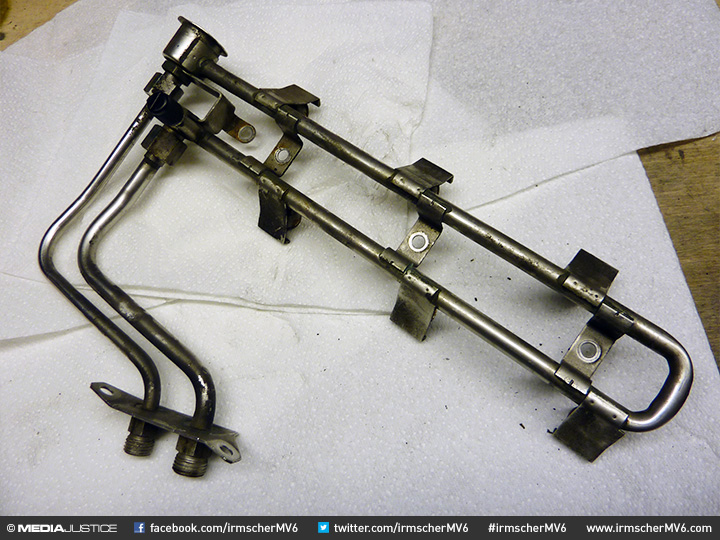

Fuel rail stripped of its injectors, loom and fuel pressure regulator before being cleaned:
Done:

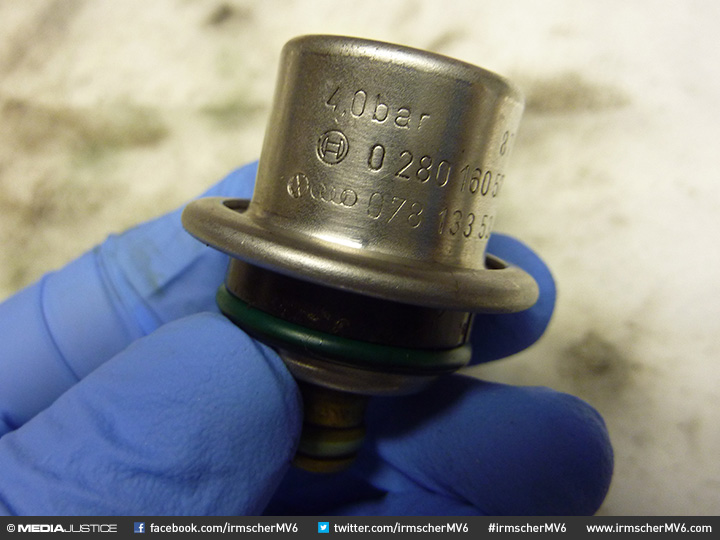

VAG 4bar fuel pressure regulator:

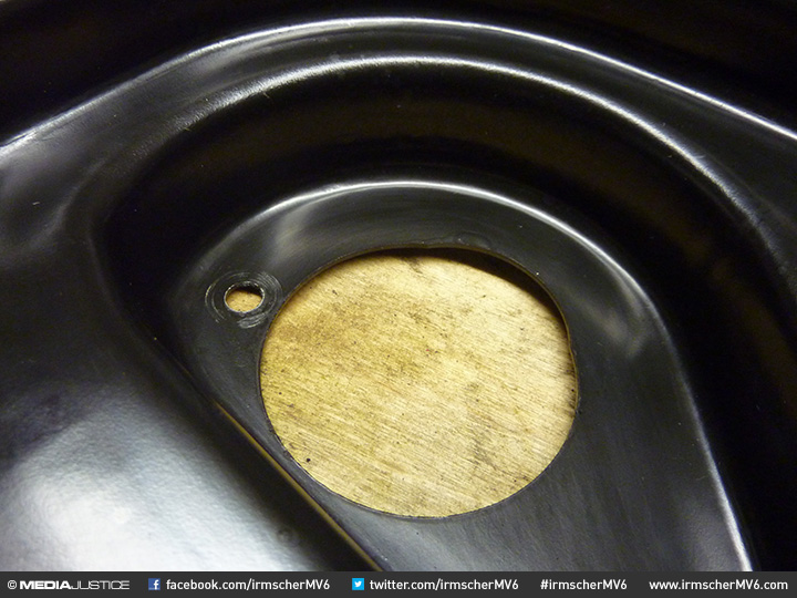

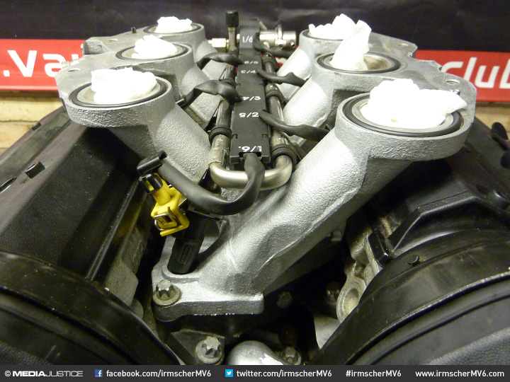

Cleaned and painted lower inlet manifold:
Reassembled with ultransonically cleaned and serviced fuel injectors:
New genuine lower manifold gaskets:
All bolted into place with freshly cleaned bolts, a cleaned loom, cleaned injector plugs etc.:

What paint did you use for the lower inlet manofold? It looks exactly like freshly cast alloy, absolutely bang on OEM look (which I very much like/aim for myself)
