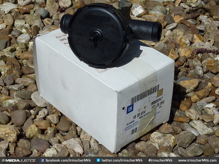

Genuine GM heater bypass valve:

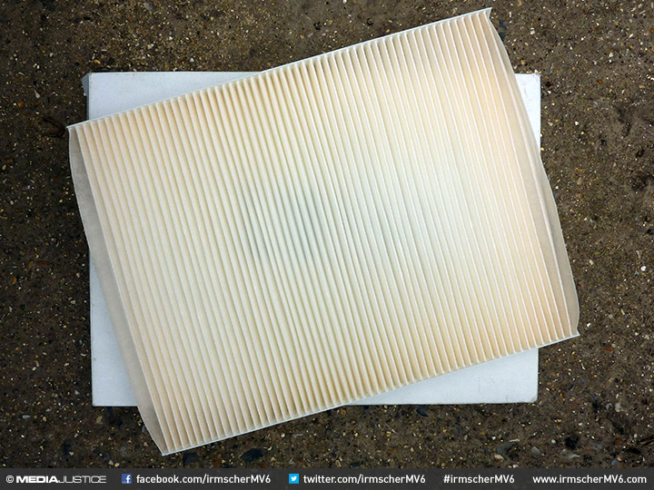

Genuine cabin/pollen filter. Thinking about it, I've had this kicking about for a while:

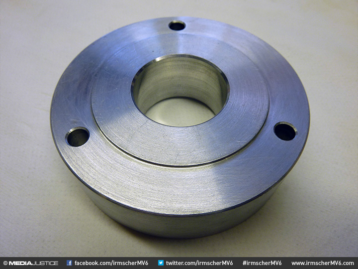

Retropower clutch spacer to enable the use of a C20XE flat-type flywheel:

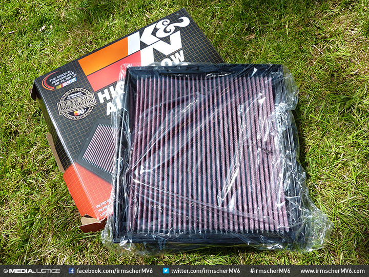

K&N panel filter (cue a sea of posts about the likely death of my MAF):

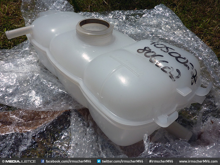

New header tank. I'm not entirely sure why it was necessary for the supplier to decorate my tidy new tank with his favourite Sharpie?! I'll wipe off his scribblings before fitting the new part:

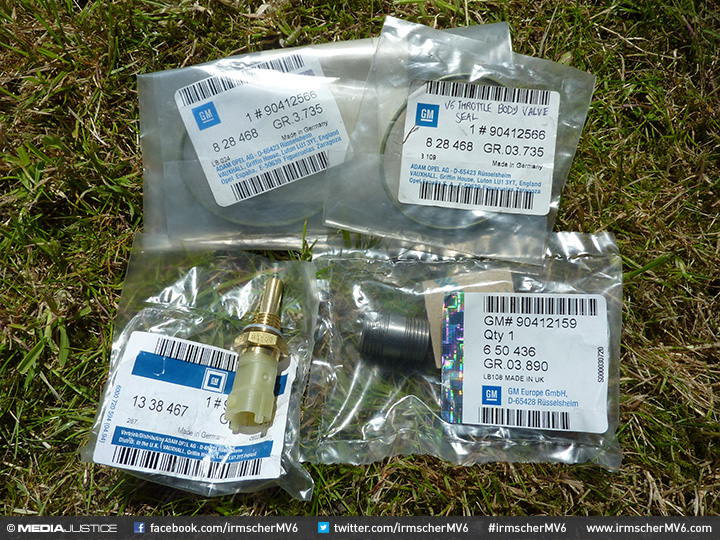

V6 throttle body valve seals, coolant bridge temperature sensor, spin-on oil filter thread joiner:

You have the wrong pollen filter though for a facelift, it needs to be a carbon impregnated version.
Where did you get new header tank ? And did come with cap and level sensor ??? (My sensor keeps telling me fluid is low when its not !!!)

« Reply #158 on: 27 May 2015, 20:20:37 »
Slight hijack...sorry
Andy...on a temporary basis....stick you finger in the header tank (when cold) and try giving the float in the tank a good wiggling and twisting.
Ironically it has worked and still is working on two of my Omega's !!!!
Worked on one of mine too. Strangely though, smashing a three month old one repeatedly with a lump hammer made it worse.
I bought the tank from Autovaux. It includes the level sensor, but not the cap. I've got a new filler cap kicking around somewhere (as well as a few spares) so not a problem.
