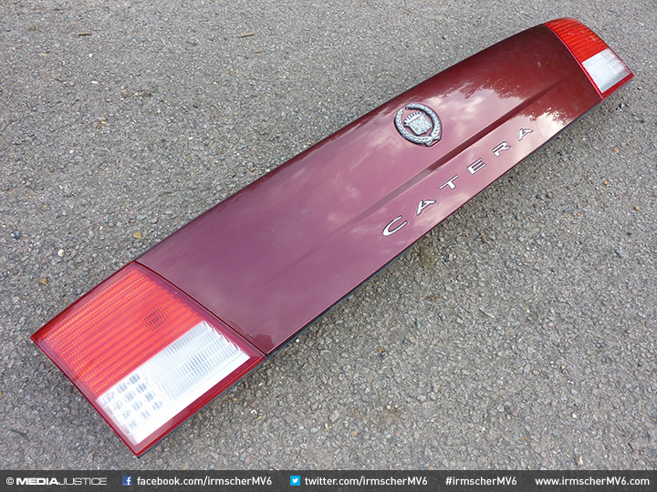

GM’s enthusiasm for badge-engineering has seen many of its European models adopt new identities before offering themselves for sale in faraway lands. On the whole, this practice has been a huge (financial) success for the company. Contrary to its earlier efforts, however, the decision to slap a Cadillac badge across the front of the Omega before firing it at unsuspecting Stateside car buyers is widely regarded as one of the biggest fails in American automotive history.
Launched as the ‘Catera’, “the Caddy that zigs” was pitched as a sporty alternative to the Detroit motor giant’s portfolio of big, V8-powered luxury barges. Unfortunately, the demand for such a car didn’t really exist, and the Catera’s reputation as one of the smallest Cadillacs ever produced – coupled with the fact that it was ‘missing’ two cylinders – ensured that its future was over before it began.
Like its earlier incarnation, the short-lived facelift variant of the Catera included USDM styling features that separated it from its Omega sibling. The most pronounced of these updates could be seen on the model’s rear end, where a redesigned ‘trunk’ housed a Cavalier Turbo-esque boot panel and a super-wide integrated third brake light flanked by LED-illuminated light clusters with red and white lenses stacked in the reverse order to those seen on the Omega.
Fitting these Yank-spec components to the Omega/MV6 isn’t possible without heavy modification to both the European and American parts. This is primarily because the Catera’s boot lid includes a dedicated recess to house its decorative panel, not to mention the fact that its inner light clusters are much deeper and much narrower than those of the Omega. In other words, they just don’t fit!
That said, not being one to take no for an answer (and in spite of being told that “it simply can’t be done”), I imported a Catera boot panel and a complete set of accompanying LED light clusters from the USA in advance of formulating a plan of action that resulted in an attack of my MV6’s boot lid with an angle grinder, splitting the boot panel into four separate parts, smoothing its Cadillac badge recesses, colour coding the altered parts and plastic welding everything back together in an entirely bespoke arrangement.
The phrase ‘trial and error’ has never been more appropriate, and it took many long nights in my garage, lots of cursing and plenty of teeth sucking until I was happy with the fit of the reassembled pieces. I don’t mind telling you that I questioned my decision to cut up these rare and expensive parts on more than one occasion, but I’m glad that I kept going - the finished article looks fantastic!

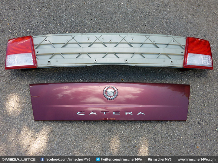

My recently-acquired facelift Catera 'trunk' panel. The required recess is absent from the Omega's boot lid, meaning that the Catera part sits a few centimetres proud of the Vauxhall's metal. The only way to get around this is to break apart the boot panel, plastic weld it back together in a new arrangement, cut large chunks out of the Omega's boot lid and hope for the best!  ;D

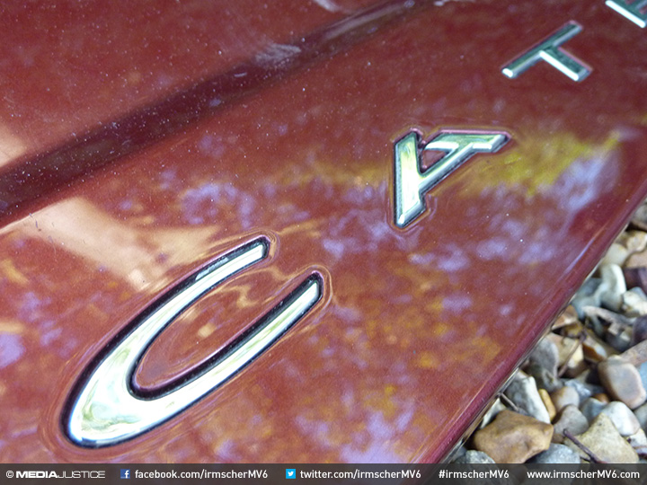

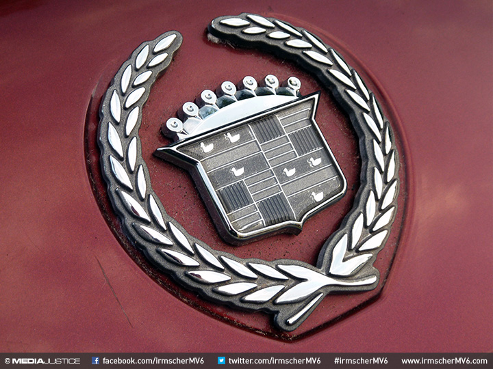

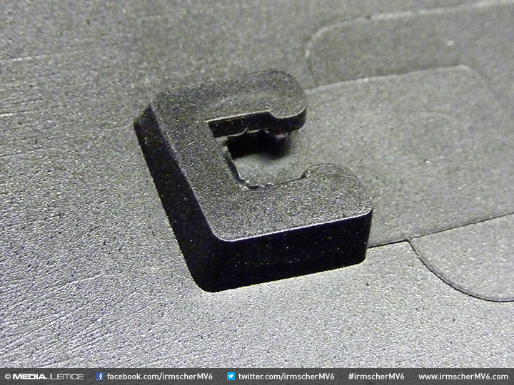

Note the contoured Cadillac badge recess. The Body Shop did a cracking job of smoothing this on the finished panel:
The individual 'Catera' letters also sit in their own recesses:
Time to split the panel:
And then some!  ;D
Note how much wider the MV6's original inner light cluster is (left) when compared to the Catera equivalent (right). The rear housing of the latter is also much deeper than the Vauxhall's part (to accommodate the enlarged rear bulb housing etc). This is one of the reasons that the boot lid needs to be cut to suit. The light casing itself also needs to be cut and re-shaped to fit.
This was my somewhat conservative estimate regarding how much metal needed to be removed from the boot lid. Trial and error resulted in much more cutting than I had anticipated:

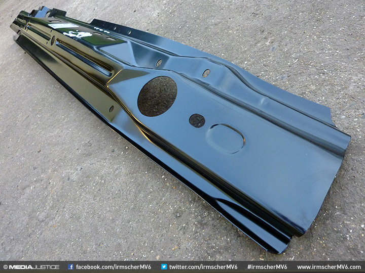

There are lots of mounting points on the rear of the coloured centre panel that need to be removed in order to prevent it from sitting too far forward:

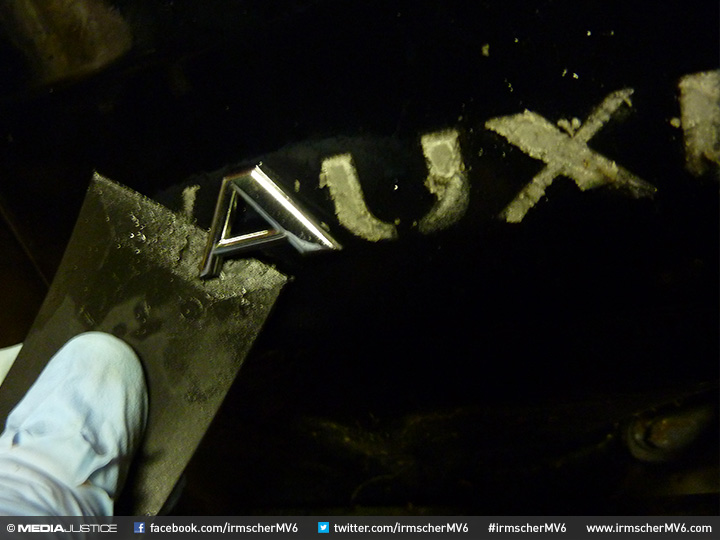

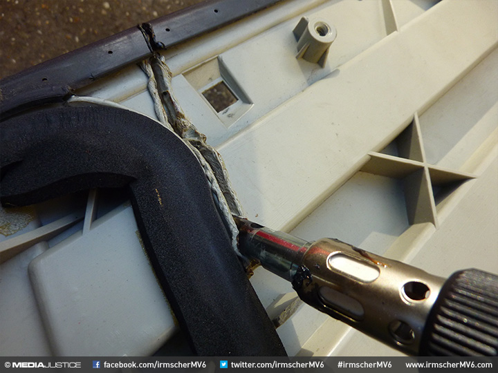

I removed all of the MV6's boot badges at the same time. A combination of Autobrite Direct 'Just The Tonic Glue and Tar Remover', plenty of elbow grease and a filler applicator did the trick:

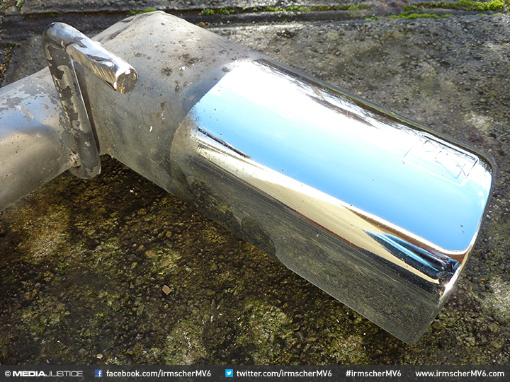

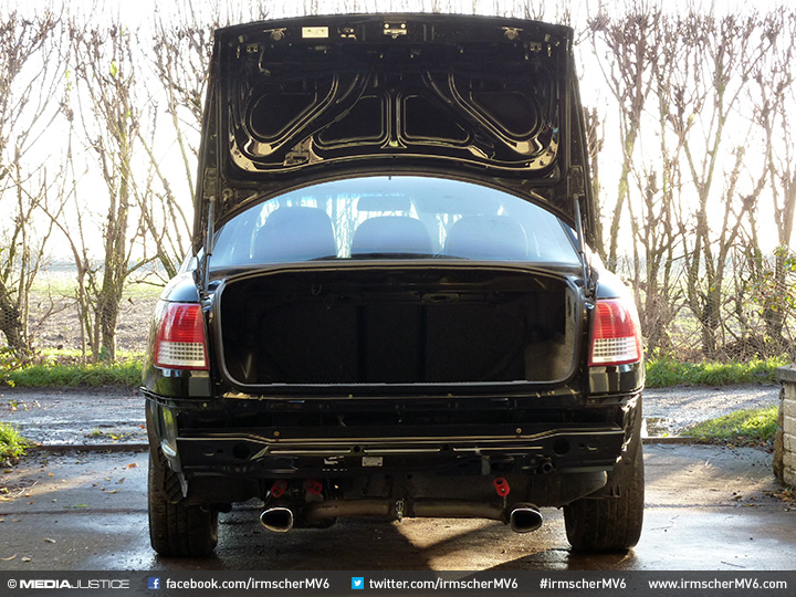

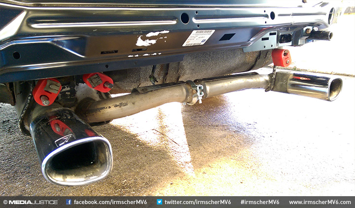

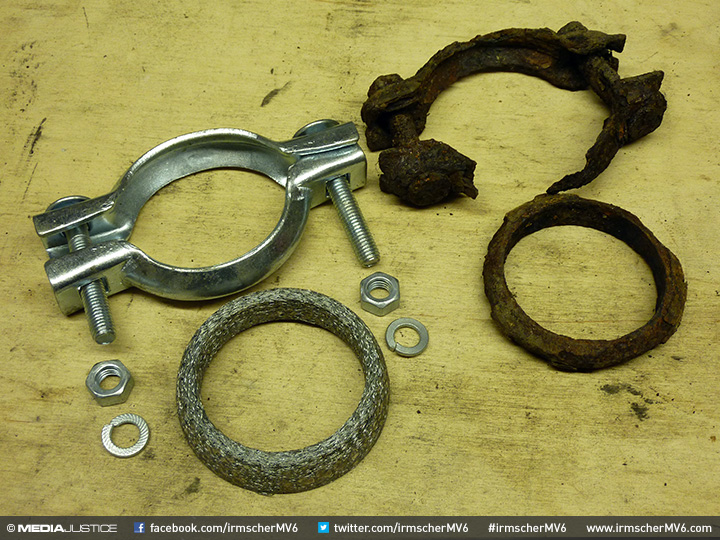

The exposed rear end of the car revealed a rotten exhaust clamp on the Irmscher twin-exit pipework. New for old:
The rear crash bar was showing its age. I managed to get hold of a brand new genuine GM replacement:

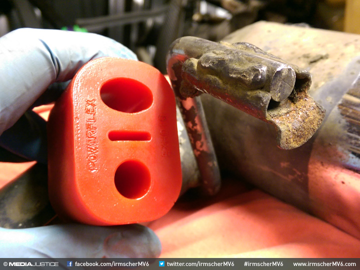

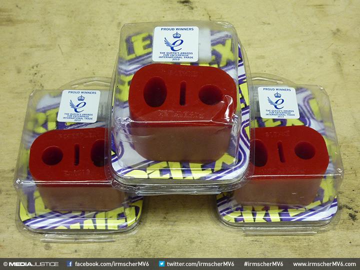

It made sense to replace the flexible factory exhaust mounts with uprated Powerflex polyurethane equivalents while I was fitting the shiny new exhaust clamp. The difference that these parts have made to the rear end is very impressive; the exhaust pipework barely moves (even when pulling at it) since fitting the new mounts. I can't wait to equip the car with Powerflex lower arm and anti-roll bar bushes in the coming weeks.
Unfortunately, the offside exhaust pipe had a hanger lip that prevented its mount from sliding on without issue. Powerflex do manufacture mounts to suit, but I'd ordered three of the type that fit the nearside hangers. Out came the angle grinder!
New clamp, Powerflex exhaust mounts, new GM rear crash bar, Irmscher twin-exit exhaust system:

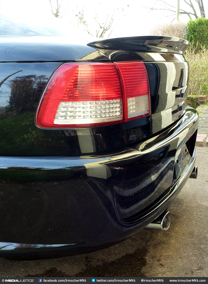

The rear end was thoroughly cleaned before installing my resprayed Irmscher rear bumper, Cadillac Catera LED outer lights, modified and debadged boot lid, modified Catera boot panel (reshaped, smoothed and painted), modified Catera LED inner lights:

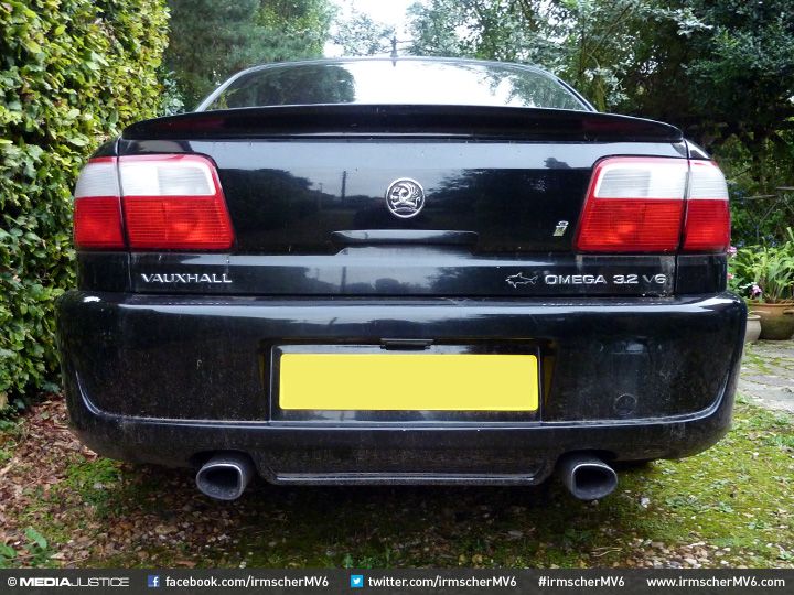

Here's a before and after comparison. First up, a photo of the rear end of my MV6 taken on the day that I bought it:
And here's how it looks today:

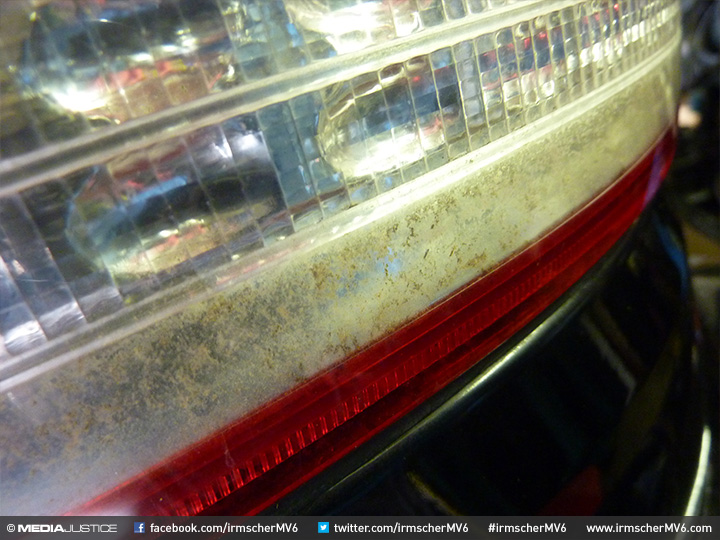

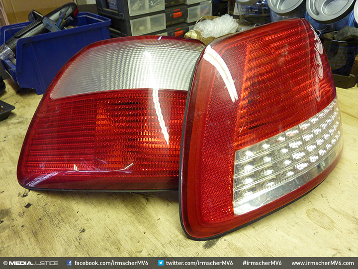

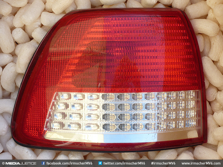

During its time cruising about the mean streets of the good ol' US of A, the nearside Catera rear light casing has attracted a fair bit of dirt and dust that has made its way into the lower part of the outer casing. It's virtually impossible to clean off, leaving me with no choice but to order a replacement light.
Here's the culprit:
Fresh from its overseas trip, here's the new light unit (protected by what looks like a box full of cheese-free Wotsits):

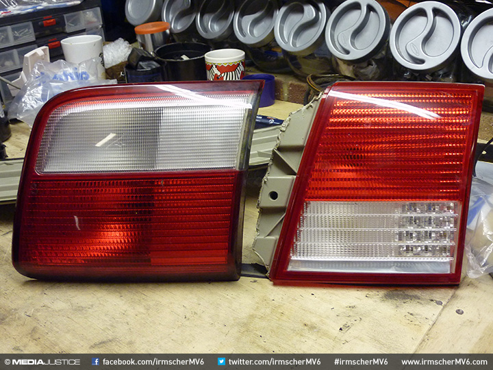

And here's the new light sitting next to the original MV6 part:
