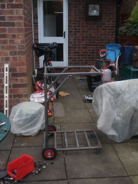

This is todays progress on the welding cart. it'd be done now if my fit up wasn't bad and I had to go back and correct it  :-[ I basically got carried away with the welding, forgot to tack stuff and it subsequently moved out of position  :-[
...I can smell the paint though  :)
 Just going to have a spot of lunch and then angled supports for the top tool tray, then the wheels, then a handle and ill see if I candig out a big enough plate for the tray  :-X if I can get that done before the end of the day ill slap some primer on  :y

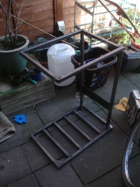

Completely agree mate. Sadly though I only have an angle grinder so I did it this way to avoid bad fit up. I'll then go in and fill in the holes with 1" square pieces welded in. Bit more hassle but as said fitment seems poor when trying to cut straight lines with the grinder.
Almost done though...

...... I basically got carried away with the welding, forgot to tack stuff and it subsequently moved out of position  :-[ ....
When welding you always have to tack the whole thing up before welding proper ...... even then, it'll move a bit.
Mitred corners don't have to an exact 45 degs, the weld will fill the gaps ..... within reason  ;)

Cant see , did you grind the welds back  :-\
Omegatitis
Webby the Bear
  • Northampton
  • Posts: 12763
    • 2000 (W Reg.) 2.5 V6 CD
Re: Home DIY Welder advice please
« Reply #28 on: 05 February 2015, 20:52:32 »
Nah, not yet steve. Couple more things to do. . . Grind, handle, tool tray plate, prime n paint  :y
