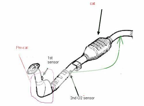

What's the code? If 0420 (which I think is bank 1, as yours obviously won't have the bank 2 code) is present, then yes moving the sensor location will fix it.
Correction, code as title ::) ;D
[/quote]
2.2 doesn't have a starting cat, does it?  :-\
Thus no option to move lamda beyond main cat as already there...
It does / should - certainly my original VX ones does have 2 CATs - in line. After market 2.2 setups don't often seem to though.
From what I can see, Lambda sensor no 2 is down stream of the second (main / big) CAT so I am not sure moving it is a useful option :-(

This is the image is wanted but it's the v engine one. So nfg

I have fitted one of these, but not on my car. Looks like the second sensor is already post main cat though....

Yes that's what TB implied. Sorry. ...up the garden path with that one.  :-[

Yup, courtesy of Mr Tunnie, can clearly show 2nd sensor already behind main cat:
Yes, 2 cats on 2.2 as well. That's the original cat, never touched sensors or anything with it. Unlike the crappy V6 DBW design, it does not need sensors moving.
As others have indicated, cannot stress enough to either keep the original CAT or replace with another known GM from a breaker.
Perhaps HG failure speeded up a sensor failure? I'd look at getting known good ones from breaker here and replace them, give the thread area a blast of plusgas a couple of days before.
Plenty of room around 2.2 zorst to remove the sensors.
