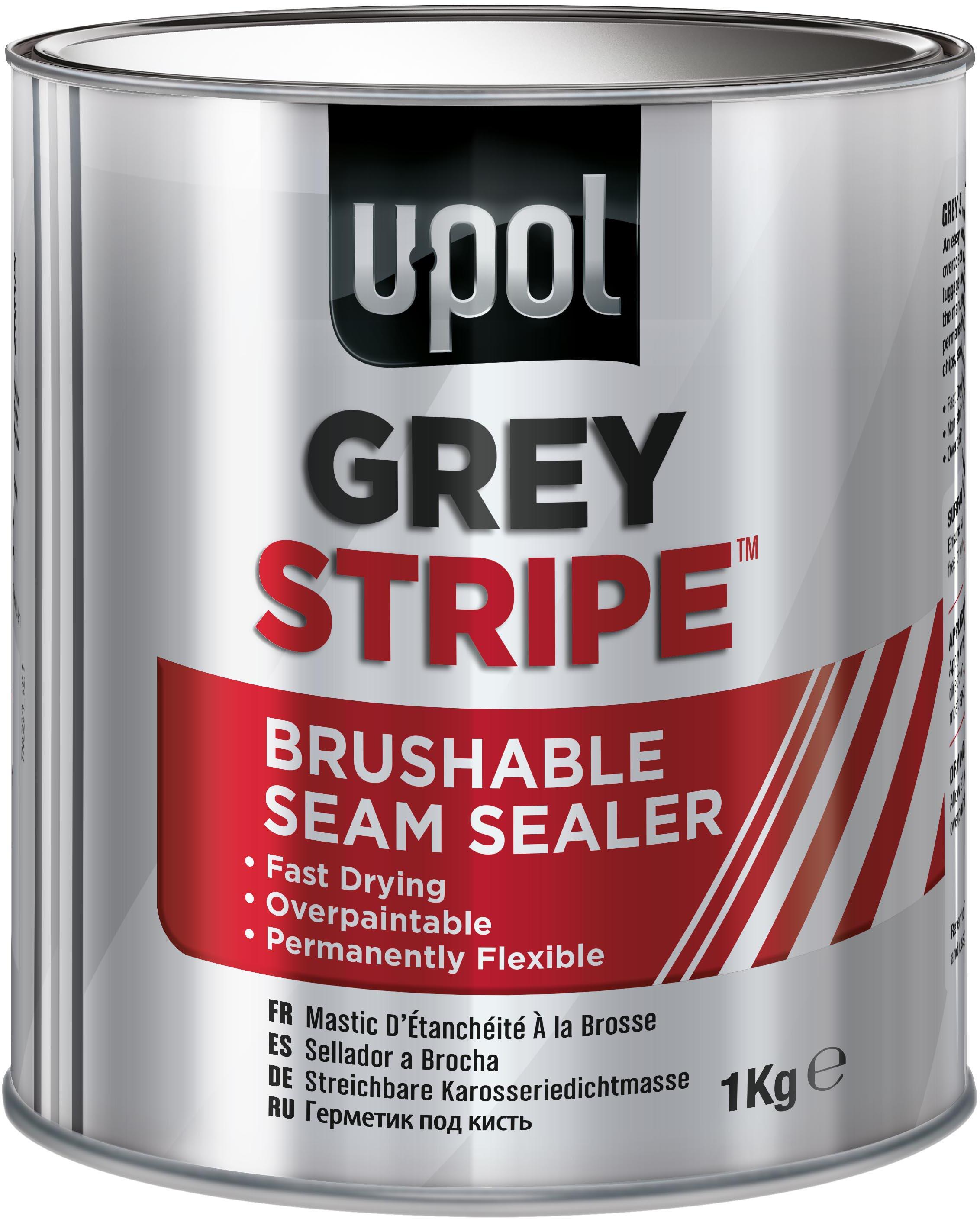

I used a stiff brush to clean all the muck off, then a wire brush on the rusty looking bits. If they're bad, a 3" wire wheel in a drill is the perfect size for the shock mount...
I then follow it with a smothering of...
Overcoated with matt black from a rattle can :y
