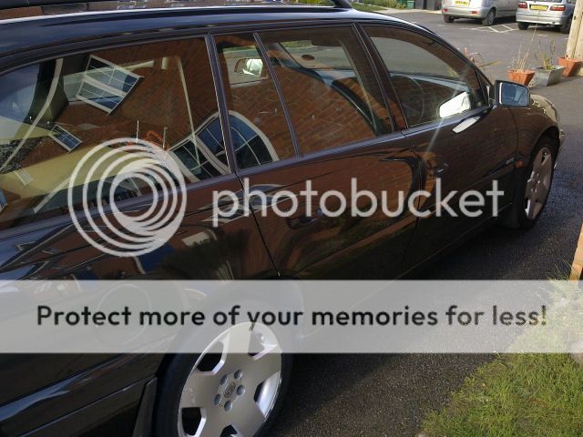

The rear wheel arches of my old black Omega were knackered.
This is the after picture.

Its not a bodge Kate if it works and looks as good as yours :y
