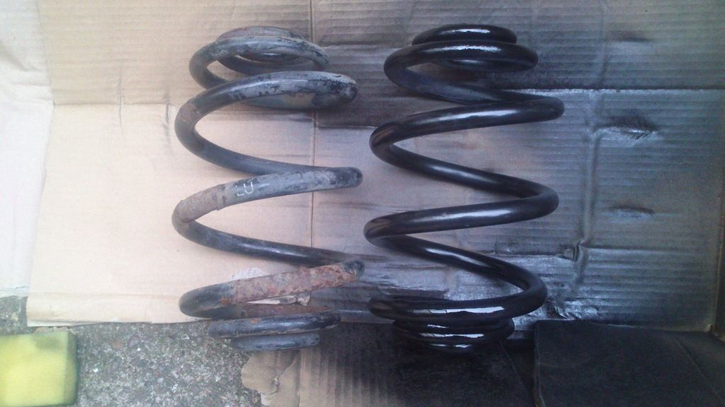

So Bilsteins can be painted? I'm terrified that my new B6s are going to be bright yellow...
I'm also debating painting the new springs black, again, red is a tad too showy for me. Since it only does 2k a year I'm thinking just black Hammerite, and treat it as a service procedure...
I hope they can be painted! haha, I did mine  ;D
As for springs, after a bit of research, the best option is to powdercoat. That's great, and will last 30 years... if you can say your springs will last 30 years without snapping you're a better clairvoyant that I. So I opted for option 2. Cheap spray paint. Apparently just as good in that there's inherent elasticity in the paint, which isn't as present in powdercoating. Hammerite is known as being a bit 'chip-prone' so this is not advised. Great for a garden gate, but a spring flexes, and will eventually cause chunks to ping off.
Must say OEM black was my colour of choice, here's a before and after with my MV6 springs, £5 aerosol and a bit of angle grinder + wire brush attachment...
