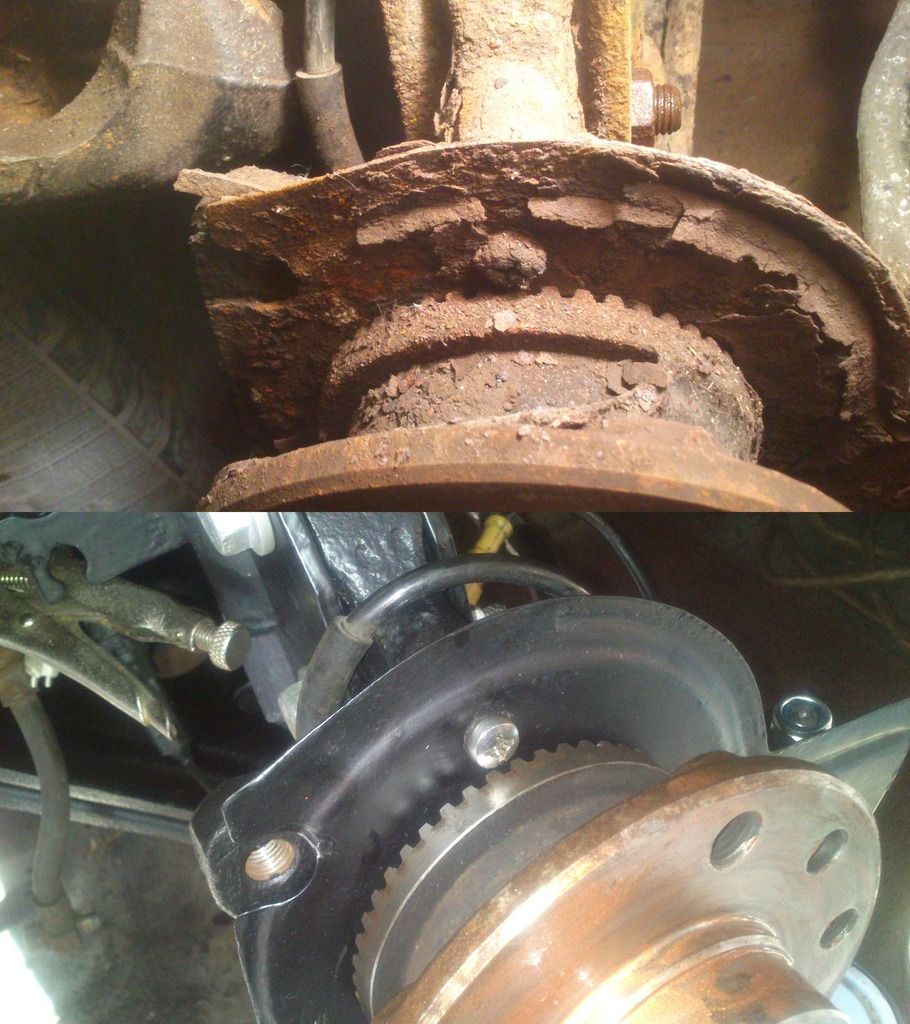

She's surely not as bad as this...  :)
That was at the start of the year.
Rotten suspension, falling off exhaust and heat shields, cracked windscreen, non-runner.
A fair whack of graft later, and one MoT with three advisories, only.  :)
here's an example of before and after...
No pretty shots of shiny Autoglym'd bodywork I'm afraid, as that was low priority, I made sure all the mechanicals were as sound as possible first. Driving down the street she looks like a ropey old dog of a car, but underneath I'd pitch her against a 3 year old car anyday!
