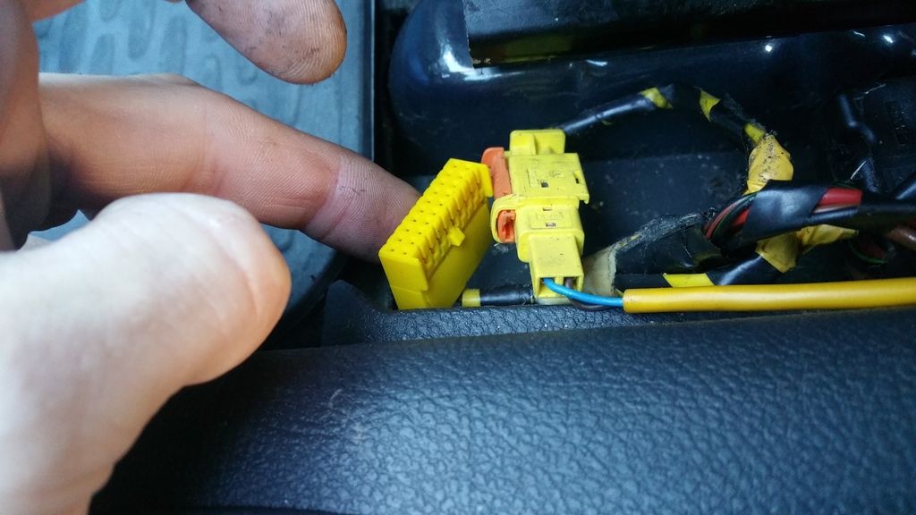

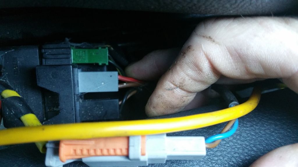

A bit of plastic stripping this morning. Anyways got the 2 covers off the front seats. The drivers side was all tidy and clicked in as it should be. No nicked wires or anything unplugged.
Passenger side was a little untidy. The wee plastic harness thing wasn't clipped onto anything and I found 1 plug that seems to go to nothing. Other than that all wiring looked in good condition. What's this yellow plug for?
Connector if front pass. seat has a built in transponder for VX approved baby seat (turns Pass airbag off)
