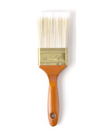

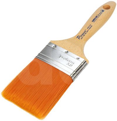

For those who don't know...this is the difference.....
Must be a cheap copy, that. They've not put the writing on back to front. ::)
Terbs
Quote from: Kevin Wood on 01 October 2015, 16:32:31
;D ;D ;D
