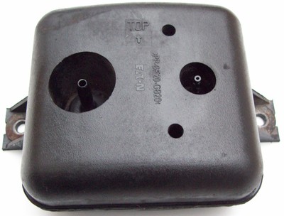

The 'check' and malady should be searchable on here (plenty of people have had the issue) but it goes something like this - bonnet open, run/stop the engine, pull off the thin vac hose that goes  into the vac reservoir at the front of the engine.
(this is a rounded black box, mounted on the air intake at the front of the engine, with two tubes going into it) as below
You should hear a 'hiss' as air escapes. If you have a leak/fault non-return valve, then no hiss. I don't recall which is the one you need to be pulling off, but it'll take a maximum of two goes to find out!  :D
There is another vac reservoir inside the scuttle, which is harder to get to, but think about it logically and you don't pull the vac hose off the vac tank itself, but trace where they go, and pull them at the other end. If any of this has gone a bit too in-depth / technical, just say. Sounds complicated, as easy as sucking a drinking straw.  :y
