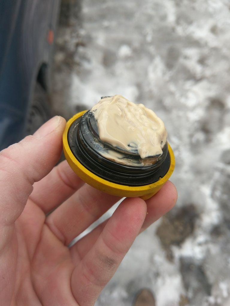

Hy guys, I know V6 can have some mayo in filler neck in winter time but this much?  :(
I had quite a few short runs  this month...having cam cover leak again after two years and I suspect HBV is leaking again (coolant under transmission when parked).
Anyone else had that amount of mayo in filler neck?

Looks about the same as my 3,0v6. Temperatures here has been aroun -10 to -15c and i have only done 16km trips to work. So im not worried about it.

Check if it's clean on the dipstick  :)
Oil on the dipstick is clean, no mayo there

Can't be oil cooler or HG then  :y
Least you can unclip the filler neck to clean it out if you wanted.
Can I remove filler neck and drive with cap directly on cam cover?
You can, although the filler neck gives the mayo somewhere neutral to collect... remove, clean and refit... repeat once a week or do longer journeys ;)
I suspect that, if you don't give it anywhere cool to collect, it will evaporate off the hot oil and get6 drawn through the breathers. Makes little difference either way as it does no harm in the filler neck.
It's especially worthwhile checking that the breathers are clear in such conditions, though, especially as any crud in them will freeze and block them completely.

Now that you said Kevin, passenger side (UK) cam cover started leaking just when the temparatures were almost -20  :-\ Breathers were cleaned spotless two years ago but could it be the gunk in them that caused the cam cover gasket  to fail ?

That's usually how it works...
Filler is the highest dead end, but once the covers start to fill up, then it gets everywhere which soon blocks the breathers...

Well that's really nice... :-X >:( part of omega relationship I guess ???
I will clean the filler neck and refit it I'm going on motorway tommorow morning, will ckeck for a gunk afterward

Yup...
Only a handful of things that fail... hbv/camcover gaskets/breathers/wishbones/crank sensors/header tanks...
Treat them as service items and the thing should last indefinitely  :y
