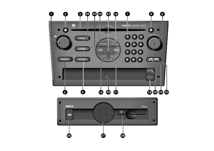

Should really be a NCDC 2015 if its got a Telephone Telematics in the Glove Box.  :-\

2013 doesnt have call buttons, 2015 does, on the 2015 the call buttons are the 2 to the right of the keypad, on the 2013 the same buttons are marked differently and are Sat Nav buttons, one of them is a Alternative Route, other is instant 'Take me Home' if the home address has been programmed into the Sat Nav Memory.
Something is a miss then, if yove got a 2013 with telematics, I wonder if it been swapped or someone has changed the front Fascia.
There are basically the same unit but the 2015 has some different button features which are more geared towards the telephone side of things.
On the Vodafone Sim, does it give you Network Signal on the Display (Top Right), GSM Aerial ok?, what you got Saloon or Estate, could also try Manual Network Selection, its all in the Manual, have a read of the Owners Manual its quiet comprehensive, if you dont have one you can download it here -
http://www.opel-niedersachsen.de/pdf/ncdcr_2011_13_15_2002.pdf

Something is very amiss, the green and red buttons which I assumed were for calling actually have a house legend and tries to activate the satnav further confirming it is a 2013.
When I insert the SIM card I don't get any network signal on the display. The car is a saloon and I cannot access any network settings as all the buttons take me to the sat nav again.
This confirms it's a 2013 according to the manual yet the telematics is definitely connected allowing me to press SOS call and showing up on the colour display and I have the option of ending the call with the rotary knob.
I had a look at the guide for model type and another strange thing about this car is that it has every option incl. Leather heated seats but they have to be manually operated with no electrical function.  ???
Well one of two things have happened then, either its always been a 2013 set up and someone has tried to add the Telematics to it, or it was a 2015 set up and someones replaced the 2015 HU with a 2013.
It is possible to run a 2013 with a Telematics (assuming one knows what buttons do what) but it will need reprogramming /  pairing up with a Tech 2 Tool, which Im guessing your need the Audio Pass Code for it. Not sure how that will effect or change the actual working of the Telephone Screen, someone with a Tech 2 will need to confirm that one.

Paired as in Security Paired, rather than just having power attached, on the NCDC's each item, HU / Screen / Telematics Unit are all Security Paired together, hence you dont need a Code when the Battery is removed, but the Code is used as part of the Pairing / De Pairing / replacing Individual Units etc.
