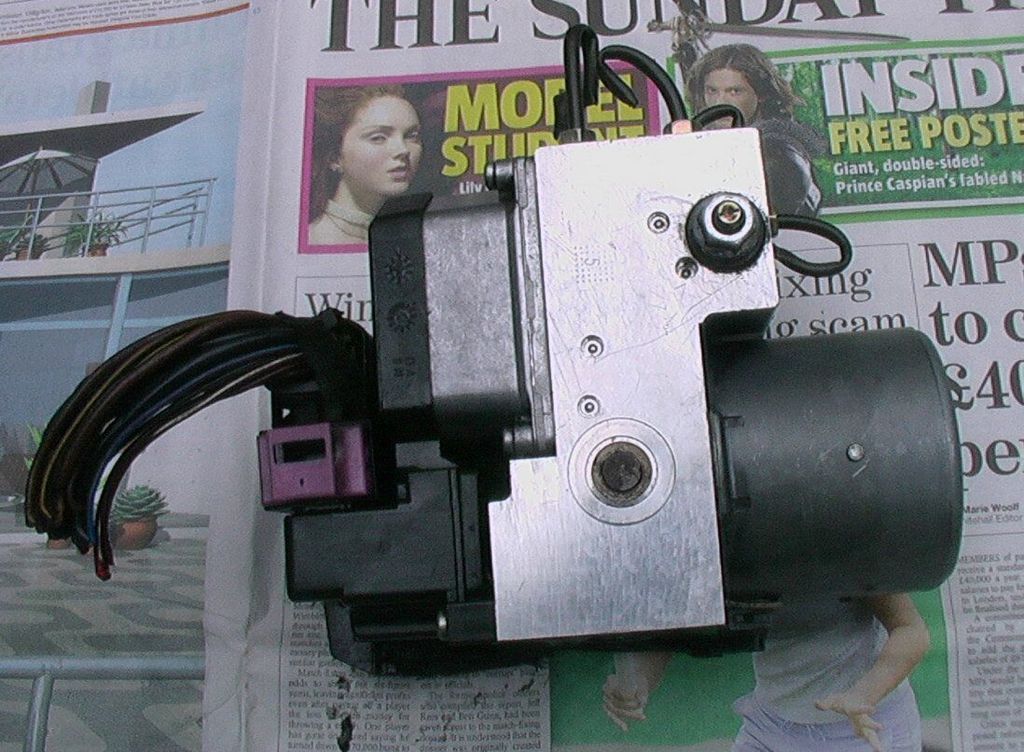

Are there any clips on the ABS Plug to push, pull, squeeze or swear at to get it off as I am sure there is Knack  :y

You should see a purple section sticking out of the right hand side of the plug.this slides out sideways and raises the plug off its pins. Just lifts off then
Makes sense :y
Pic Courtesy of another OOF'er - Ta  :y
