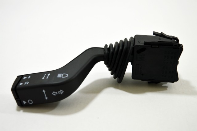

What do you mean by stalk? My native language is Swedish and I know what a stalk is but not on an Omega  :-[
Jan Suhr
Stockholm, Sweden
www.protouring.se
  • Posts: 37651
Re: Opel shop couldn't change language on GID display
« Reply #7 on: 29 September 2017, 12:57:10 »
One of these:
Could not find a photo of wiper stalk with buttons, here in UK one that controls indicator/lights, also controls cruise.
The wiper stalk is only wiper with NCDC, but other H/U's say 2005 unit, it also controls the MID, try pressing and holding the long lower button?
