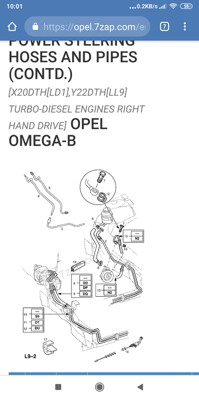

It would be a big help if someone could confirm where the lower of the two pipes finishes up on the passenger side of the vehicle please. I initially thought it ends up screwed into the pas pump itself, but now I'm not so sure and its a bugger to trace its course.
Also, does anyone have a part number for the lower pipe? If I attempt a repair and that fails I'd like to know where I can get the part if I can't get one through here.

Re: Pas pipe advice needed
« Reply #18 on: 22 June 2019, 10:06:23 »
Looks like it goes to the reservoir.
« Reply #19 on: 22 June 2019, 10:15:18 »
Thanks, I think you're right.
« Reply #21 on: 23 June 2019, 11:02:09 »
The pipes go from the steering box along the chassis rails,across the front then up the chassis rails on the other side to the resovoiar and pump. It's a bit awkward to post.
