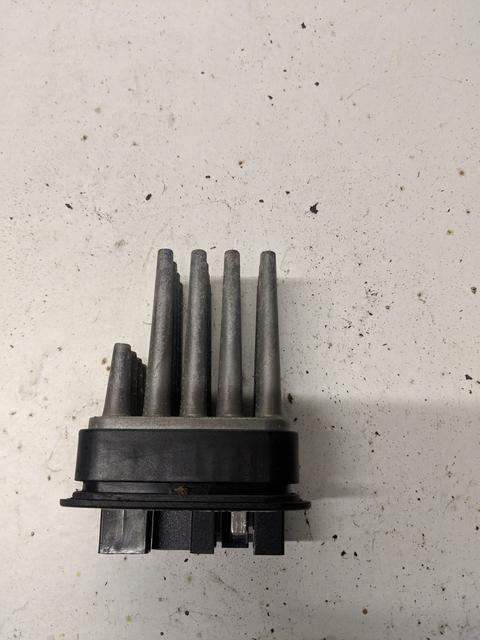

do you know part number?
or how it looks?
some photos will help me  ;)

A hedgehog. Look in for sale section.. :y

The fan itself is electrically pretty simple, it either works or it doesn't. So if high speed is missing but the fan is otherwise OK then your hedgehog (speed control unit) is likely faulty.
You can test the fan without removing it by unplugging the connector and connecting the two big wires direct to battery voltage. It should run at full speed. Alas there doesn't seem to be a reliable test for the hedgehog.
Be very careful putting in a new hedgehog as it is extremely easy to break the clips that hold it in position.
