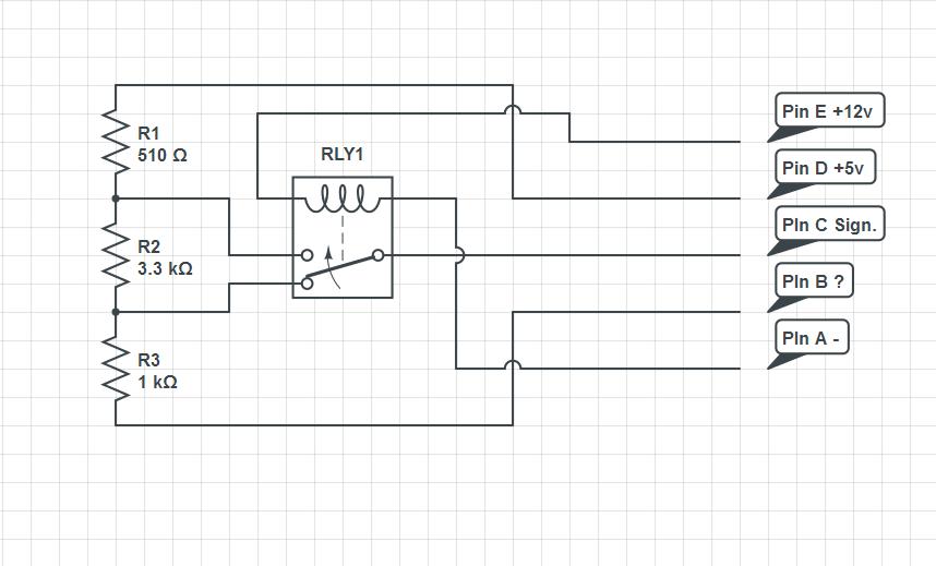

It cant be to hard, the cheaters just put a small relay in place of the EGR solenoid and then the contacts switch a set of resistors to model the feedback signals.
There was a circuit on line which was basically that, needs the V6 EGR pin out checking/measuring to get it right
  • Posts: 34112
Re: EGR cheaters... how, who, what n where?
« Reply #8 on: 29 July 2019, 16:45:08 »
A quick look suggests A and E are the solenoid coil
D is 5V feed
B is Gnd and C is the feedback signal
So something like:
Although the feedback resistors may need some tweaking

There's a similar diagram on the forum elsewhere, and i believe they used a Carlton relay to a four pot cheater. As I've said before I'm no electrickery-minded person, but wanted to see if anyone had yet come up with a simple plug n play option. Thanks to Mr Fuse19 as always.  :y

« Reply #11 on: 31 July 2019, 18:48:52 »
And circuit diagram:
