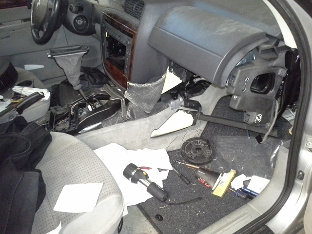

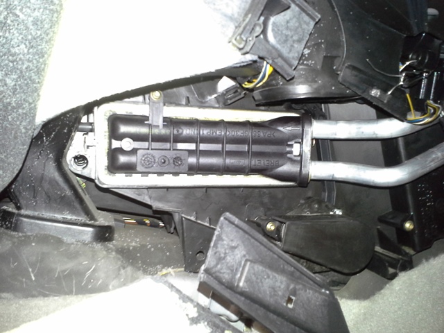

https://i.postimg.cc/gcBT85dQ/20161225-110016.jpg
Understood your steering wheel is in the left, can you open the link above? I just "skimmed" the vinyl away without cutting it. It was just glued to the foam. Then I cut the plastic part in a place seen in photo and bent it down with 2 kg plate. When job jobbed I joined the cut parts with two narrow and thin metal sheets and screws and glued the vinyl back. It cannot be seen at all that I was there.
