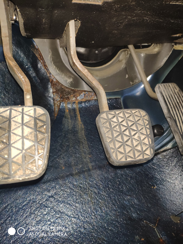

« Reply #22 on: 20 November 2019, 10:28:02 »
<a href='https://postimg.cc/DSqzZ7pk' target='_blank'><img src='https://i.postimg.cc/DSqzZ7pk/IMG-20191120-105440.jpg' border='0' alt='IMG-20191120-105440'/></a>

Managed to upload first pic, other two won't  :( Rust hole behing the pedals :-[ ...a year after I replaced rear panels and wheellarches :-[

Bulkhead repairs are in restoration territory  :-\

Exactly the same area as mine was but worse.
If you take the front wheel off and look in the arch where all the panels meet, you will find a small hole there. You can patch that from outside as a temp thing until the weather warms up a bit for a proper look. Just treat the inside rust for now to stop it spreading

Yes Iansoutham, there's a hole there and I can see right out trough it. I just came back from an older fella who owns a bodyshop and he said it needs to be patch welded. Two days work he said. The same guy who replaced rear panels and wheellarces last year. I'm taking Omega there on monday morning.
Thanks for your help guys.

Leak sorted out, rust cut out and patched/welded, all nice and ok BUT
thick sponge-like insulation material under the driver's footwell has disintegrated into small pieces and is unusable now.
