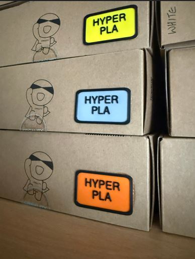

So, these are easy to create using the Layer Painting in Creality Print.  Just create the model in Tinkercad, and paint the top 3-5 layers as black.
Or painting using objects, create a flat 50x30x1mm rectangle, import into Creality Print, use the Test Tool to add the text, and change the colour of the Text object to Black:

That's useful to know thank you, I'm glad I wasn't missing something obvious in tinkercad.
I haven't played with the proper slicer yet, only the cloud based one and the phone app, so not sure if it's possible there but I will have a play at some point.
The main use case I've got is exactly as you described here, labels, raised text or similar so changing at a specific layer height should work just fine for me.  :y
