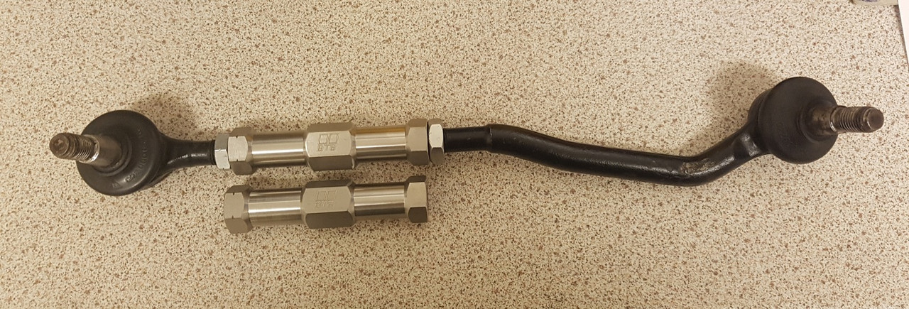

Ditto my MV6 does the same. Was much improved by changing the front top mounts and resetting the front camber to 1.0deg.  More than 1.0 deg causes the front to "tramline" (ie follow the camber changes in the road or white lines, lorry ruts etc to a sometimes alarming degree. It is a problem that I am familiar with from years of working on Lotus Carltons. It is made worse on an LC by the wider rear track.  I have also found that however tight that you do the adjusting bolts on the front struts they don't hold the camber. So now we use Eibach camber adjusting bolts (ebay them) for the top slotted bolt hole, which work well.
I'd like to say we cured the MV6 this way, but it does still swing about a bit on undulating roads, even ones that I drive on regularly.  So I suspect something at the rear, most probably the big subframe donuts is also contributing. The Lotus's have much harder donuts, so probably don't suffer as much crabbing due to horizontal movement of the front of the subframe.  They do however get axle tramp when the inner sleeve separates from the rubber leading to excessive vertical motion.  The Lotus donuts are NLS of course so a poly replacement from pedders or similar is on the shopping list next.
I fitted these for ease of future tracking adjustments, which we made from Stainless steel bar.
