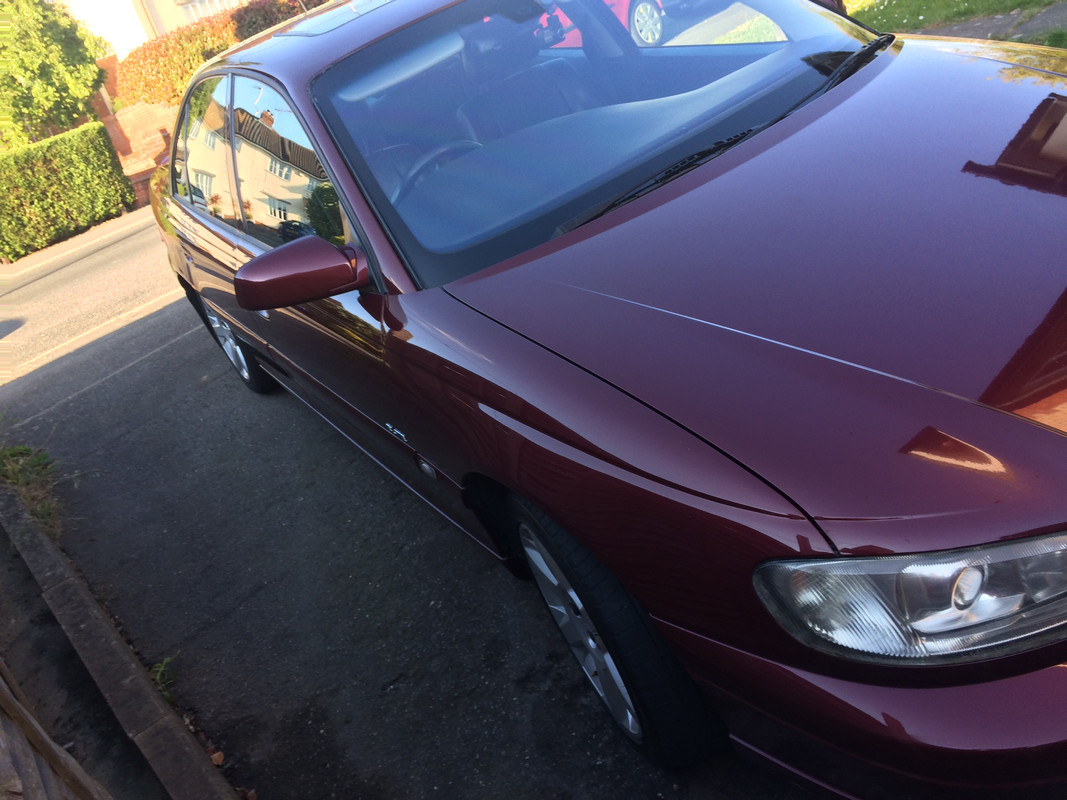

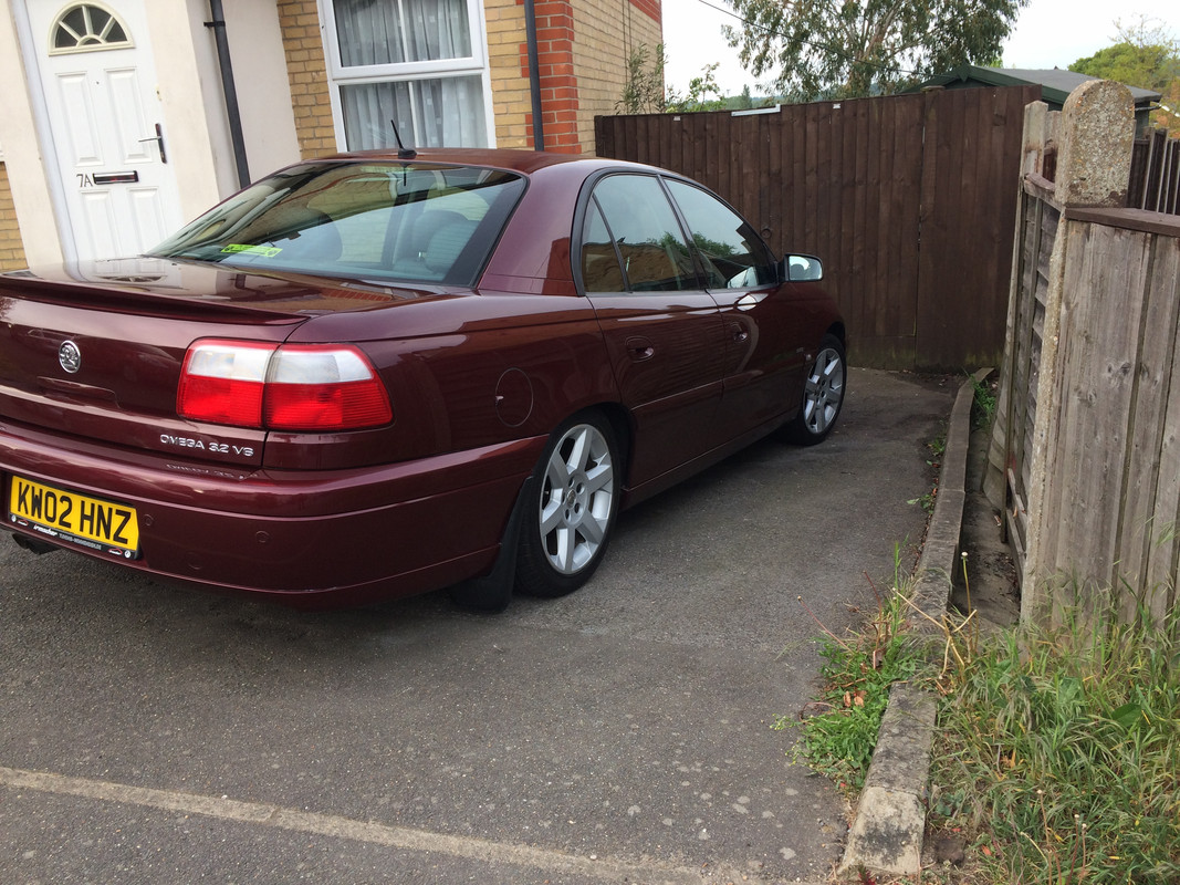

« Reply #44 on: 17 May 2020, 13:24:18 »
I didn't spend money as I already had some stuff in the shed, but spend a lot of hours over four days and was knackered at the end of it.
Not great pics, but hopefully give an idea. Main thing is I managed to get rid of all the big scratches on various panels on the car.
That is a reflection on the n/s/r corner by the way, although it looks like something running down the paintwork.
