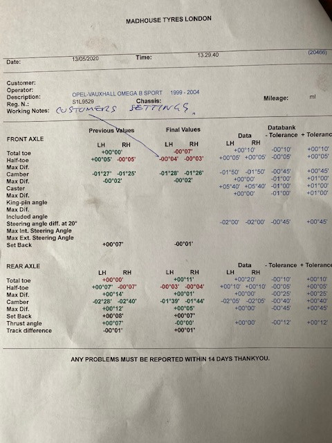

Well got the car back this afternoon job done not exactly perfect but done a reasonable job :y.......all in including rear track rods fitted £250........took the car to Mad House Tyre got the tracking done, gave them the settings, see results below, not exactly there but nearly.....
Tracking.....

Arse end looks fine :y
That front camber needs re doing, because they clearly didn't even try :-X

« Reply #34 on: 13 May 2020, 18:18:59 »
He said that was the best he could get it :o
Bollix.
They didn't even undo the nuts.
That's to say, the numbers are unchanged from the 'before' list so clearly they're talking Bollix, not you ;)
rubbish. There's easily 6° of adjustment just by loosening the strut to hub nuts and prying on the wheel.
Those figures of 1°28 will wear the inner tyre edges and make the steering really nervous. It should be more like 1°10.
Cheers for the feedback, will be going round there this morning, get it sorted :y
