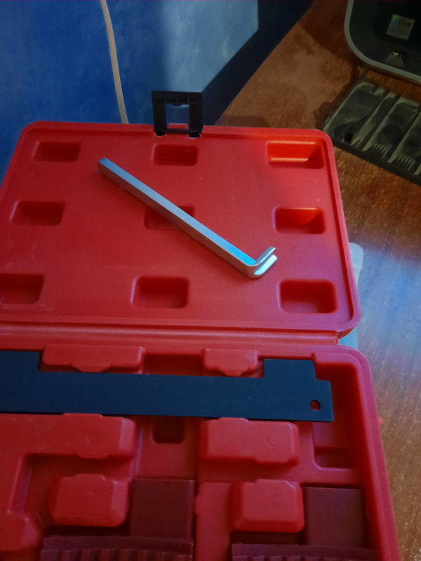

What is the bright/grey tool in this box? What to do with that?
dave the builder
  • Derbyshire
  • Posts: 7895
    • omega b2 2.6 cdxi
I've never used it , I think it may be used to lock the flywheel on another engine
these kits are clones of genuine GM workshop special tools ,very little info is available
I just used the tools i needed for 1.6 petrol 4 bangers from the kit  ;D
the thin wire type thing is obsolete (was to lock the cambelt tensioner but  they changed the design of the tensioner to be held back with a hex key (not included in the kit)
the thick round bar is to lock the aux belt tensioner
flat bar to lock the cams if you remove the head
Have fun  ;D
