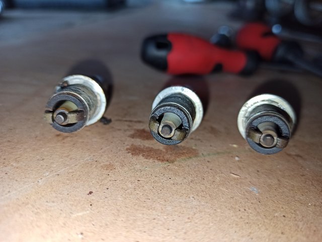

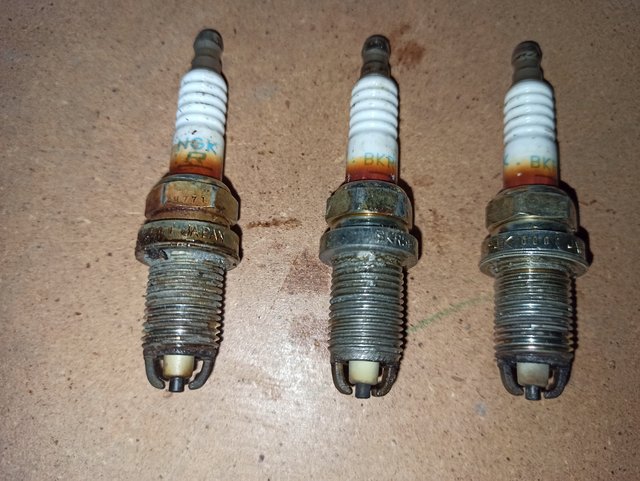

danzigfan
  • Jesenice, Slovenia
  • Posts: 1482
    • Omega 2.5V6, 3.0V6
Re: Missfire
« Reply #11 on: 28 September 2020, 10:31:39 »
These are from left bank, all look the same :(
  • Chatham, Kent
  • Posts: 11083
    • Ghastly 1.0l Focus
Re: Missfire
« Reply #12 on: 28 September 2020, 10:35:52 »
How long have they been fitted, as they're utterly oppsed :o
And does your scuttle leak? That might explain the brown marks around the insulators.

« Reply #13 on: 28 September 2020, 10:40:23 »
They've been in for 20k miles and yes, the scuttle doesn't leak as I sealed it per guide on the forum. Plug wells were dry

« Reply #14 on: 28 September 2020, 13:05:45 »
Are some of the sealing washers missing or damaged on those plugs?
If the scuttle was leaking it could have dripped water onto the coil pack. And damaged it.
Try new plugs since they look like they need to be changed. However my guess is the coil pack. If yours is original it must be a record for longevity.
