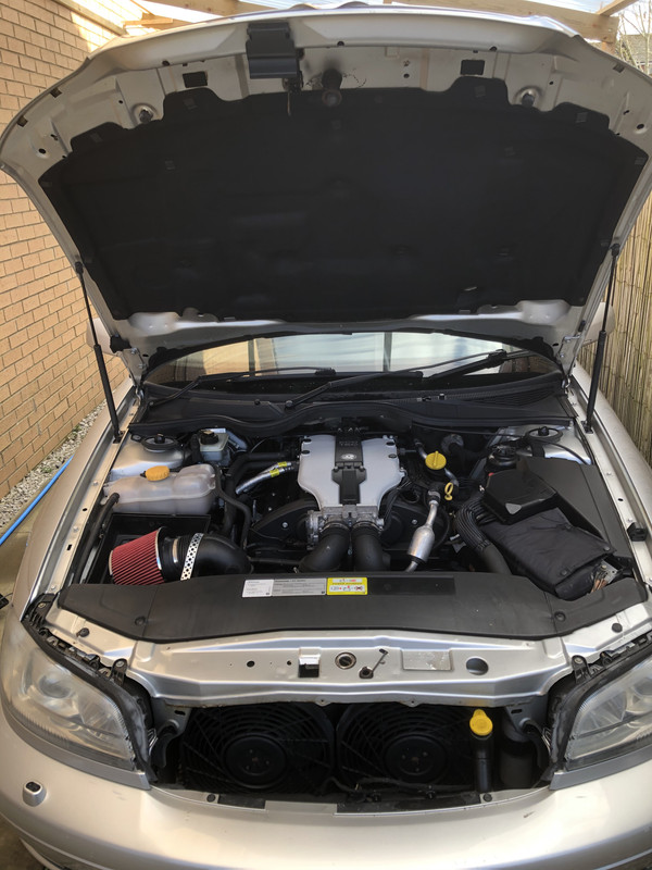

Bit of an odd one here first drive after installing big air filter (as seen below if my link to pic worked)
What a lovely noise though still quiet when driven gently
Anyway once engine had warmed up I floored it which led to loads of noise but massively down on power then eml light started flashing then stayed on permanently, got stopped at lights and car was juddering at idle misfire I think
Limped it home shut it down and popped bonnet all seemed fine restarted engine no eml no misfire
I'm confused maf sensor not happy? Or unrelated problem occurring randomly?
Car runs and drives beautifully till now anyone else had issues with same?

Just my thoughts. But you are dragging warm air in, from around the engine, which is a massive heat source. Warm air is not what you want. Cold air is better for performance. Probably the ECU is backing everything off, because it sees lots of warm air.  That is why intercoolers are used, cools air down. More cold air, more bang in engine = more power.
So you have made the engine power etc. worse by doing the conversion.

Maybe I am missing something on this, but why would you fit a "big air filter" to a 2.6 Omega with a standard engine?
It was designed to have the air filter as fitted in the factory, so why do a boy racer up date?
If you go back to the original design I am sure your troubles will be over :D ;)

Did you measure the ambient air pressure, and the air pressure in the standard air box after the standard panel filter, before you binned it? That way you would know how much of a restriction the standard setup imposes.
No? Thought not. ::)
The only thing a performance air filter will do on an Omega is allow more/larger particles through, leading to increased engine wear. And it'll allow hotter engine bay air into the manifold, rather than cooler external air, thus reducing performance.
If these things had any real world benefits, manufacturers would fit them as standard.

1. The air filter... Aside from the previous observations, is it oiled? If yes, then you might have killed the MAF.
2. Fuel/historic use. If you're running crap fuel then that can make the EML flash. Likewise, if the car has been babied, then the sudden change of use won't agree with the established parameters in the ecu.
Firstly, refit the standard filter/housing.
Secondly, get the codes read* and report back.
* pedal trick may or may not work, but it's a start :y

Thanks for the advice from the helpful members I'm going to refit the original box and filter and go for a run
Hopefully will be back to normal which was brilliant anyway
Filter wasn't oiled so hope maf is ok
Only used super unleaded since I got it
As for why modify my car well because I can and I like to but if you have to ask that question then your not going to get it  ::) all cars are manufactured to a budget and fuel economy targets and several cars I've owned have benefitted from intake and exhaust improvements and several threads on this forum have discussed improvements from such
If this car doesn't benefit from modifications I'm happy to just maintain polish and enjoy

If you want to improve airflow, do some research on aftermarket performance panel filters such as K&N, it will fit straight in as the standard item and benefit from the cold air feed already built into the original system.
