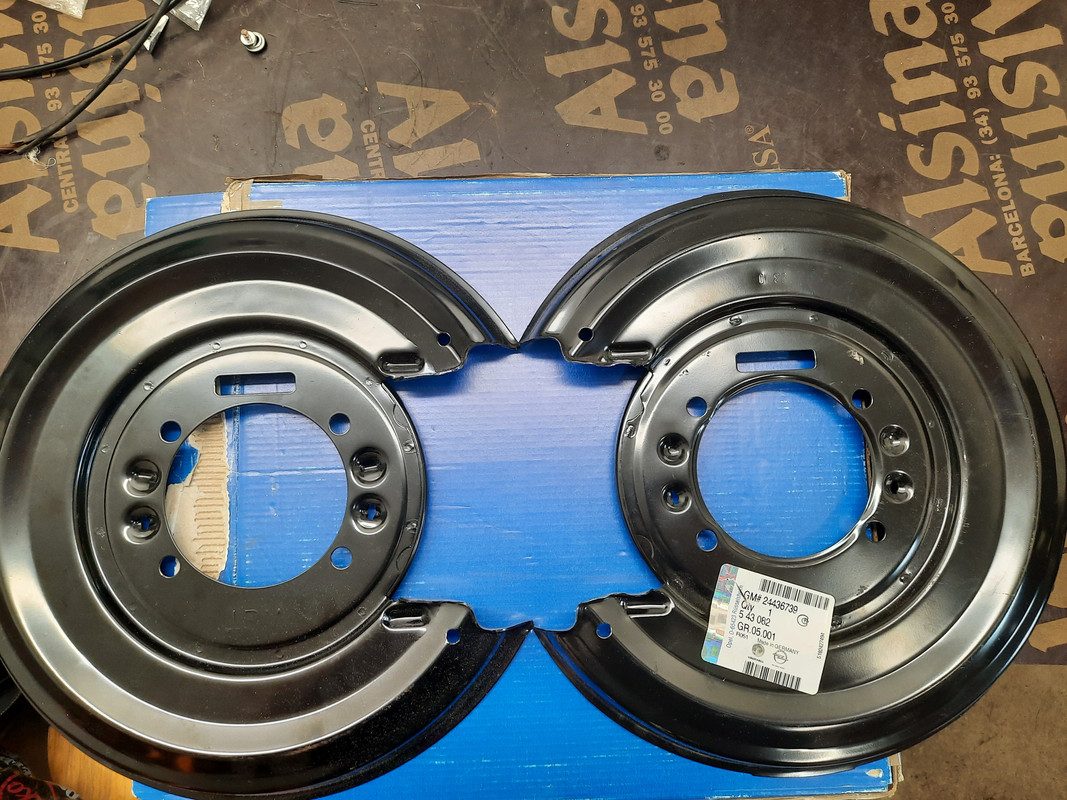

Succeeded to find original GM 24436739 from Germany and for the other side unbranded one from Finnish supplier. Both are that style where pin is put from front.

What part number was the unbranded one supposed to match? 24436738 to fit an Omega B?
Or was it sold as fitting an Omega A, Senator B, Vectra A & Calibra?
Yes, I bought that to my Omega B. I could put them one upon another and take the new pic. I think they are similar (L&R).

Your picture is perfectly clear :y
The difference between them being the slot for the parking brake lever is below the hub... The right one in the picture is 24436738 is the right hand one and it would therefore be reasonable to assume (without looking because I CBA) that 24436739 is the left hand one... ;)
Corrected.
The difference between them being the slot for the parking brake lever is below the hub... The left one in the picture is actually the right hand one and vice versa so 24436738 is the left hand one and it would therefore be reasonable to assume (without looking because I CBA) that 24436739 is the right hand one... ;)
Yes, they are upside down but left one in picture is for the left side of the car I guess...
You are correct, I hadn't initially realised that the face shown is the diff side not the wheel side ;)

« Reply #26 on: 15 August 2021, 16:22:07 »
Yes, picture is from "wrong side" just wanted to show the label without removing it.
