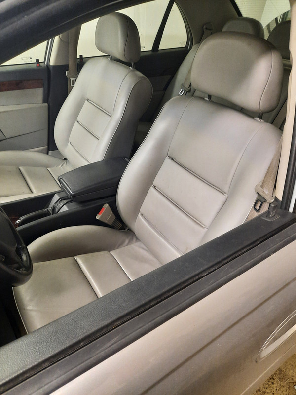

So seats changed. My originals did not have memory and these new either.
I'm happy, like new.
Referring to this:
https://www.omegaowners.com/forum/index.php?topic=149020.0
I am not sure what the material is. Feels more leatherette. They are original seats from FL 2001 which I have, too. Perhaps center parts real leather?
Referring to this:
http://www.omegaowners.com/forum/index.php?topic=90680.0

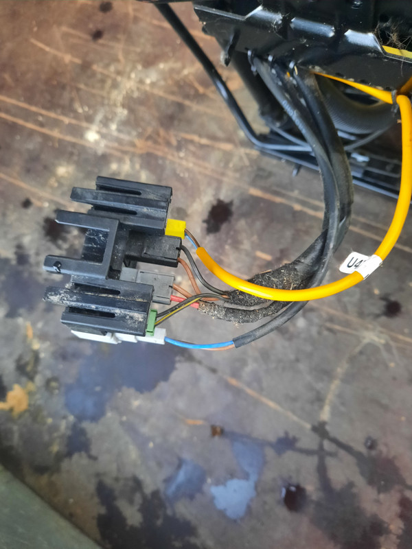

I did not do any soldering yet as I did not understand the text well enough. At least all the movements work like tilting the seat, back rest and moving front/back. The connectors were similar so just plugged... Heating not yet tested, could that be the problem or why this soldering? Below fig of connectors of my original drivers seat. Do "Elite Seats" differ from these?
And last comment: Both driver side and passenger side required longer bolts.

The soldering is to bypass the mirror position memories as cars built without memory seats use different mirror wiring. AIUI ;) if the seats are working fine, then I wouldn't worry about the soldering.  ;) (that may be a specification difference between UK and Euro cars...)
