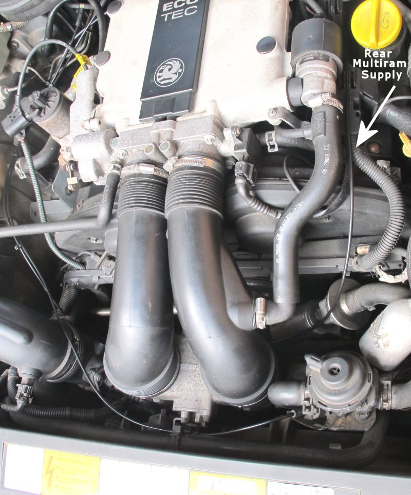

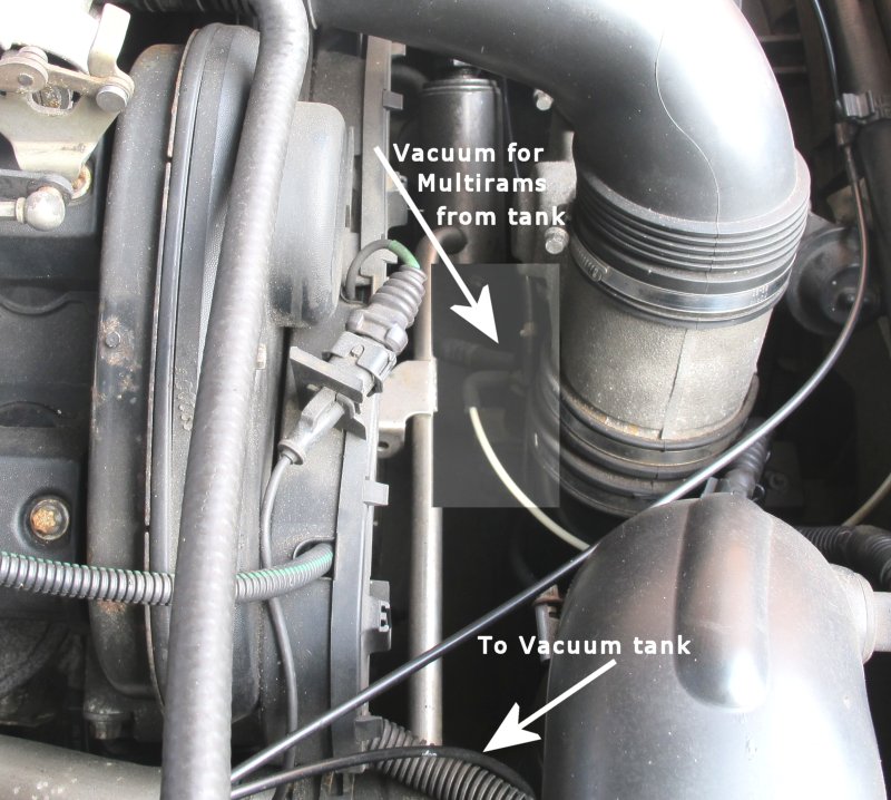

Here's how it should be plumbed up, although I've modified the routing on this car to make it simpler. Also avoids having to run the 2 pipes across the bulkhead and clutter up the already busy area over the cam covers. I hope this helps  :)

That confirms the difference between the vac lines on the 2.5/3.0 and the later 2.6/3.2 :y
The OWV with two spigots is clearly visible on the earlier set up :y

Thanks Tick Tock. Great pics.  :y
To avoid confusion, do you have a 2.5 V6? With mine being a 2.6, I presume that it will be a bit different by the bulkhead (as per Doc Gollum's post)?  ???

Yes, sorry I should have said it's a 2.5, but there's not a great deal of difference.
