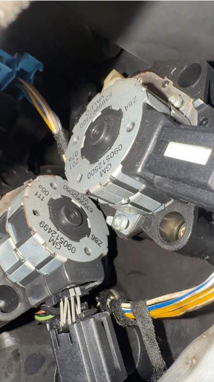

Like the title says, I'm not getting almost any heat inside at all. I've replaced the heater matrix thinking that it was the culprit. The old one WAS leaking and clogged from some kind of headgasket sealer, but I'm still not getting any heat. There's a loose vacuum hose (?) that's black with a blue line that has been blocked off with a bolt from the previous owner. Nearby is a vacuum actuator connected to what I'm guessing is the recirculation system. So I'm guessing not very important. Above the heater matrix are 3 servo actuators with one of them having a broken connector just hanging. I connected it back, but no heat. Doing the climate control "reset" by pressing auto and off at the same time makes the servo with part number 090512500 move but the two other's do not. The servo that had a broken connector was numbered as 090512499.
Here's a picture of the servo with broken connector.
Is there any info on what exactly these different servo motors adjust? Which one might be responsible for mixing heated and cold air?

The actuator arm in the video isnt easy to see when your in the car. Also a much more obvious one connected to the same servo which operates a flap nearer to the driver.
The one in the video had come adrift on my car and I had the same symptoms as you. It took quite a while to find it.
In fact I only found it once I discovered that video on youtube.

This is the one directly under the heater matrix, correct? I'll have to check the arm. How would I know to test this? Just turn heat to LO and HI and see if it moves?

It comes from up above the matrix, runs down alongside the rear of it, then bends around to connect to the servo motor.
You need to get your head down on the floor and shine a torch in there to see it.
Yes just turn from Hi to Lo and it should move. If it isnt moving take the servo motor off and reattach it.
The other part connected to the same servo is different. Its actually a metal rod which goes to a flap on the cabin side.
As can be seen in the video, the matrix pipes give you the location to look at for the black plastic connector.

The lever seems to be moving fine. I noticed that when it goes to the "high temp side" air flow from vents decreases signifcantly.
