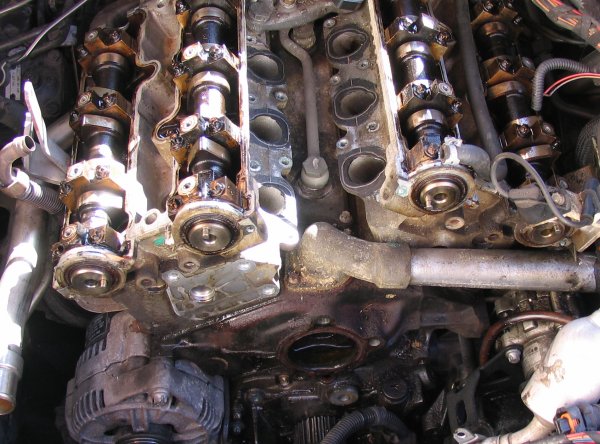

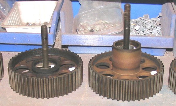

Following this with interest, even if I'm no help in knowing where those dowels / rollers have come from. The following pics show the cam sprockets and camshafts, so I doubt that the dowels would come adrift when the sprockets are fitted and all 4 timing marks aligned.

So, with the crankshaft line mark pointing vertically down (6 o’clock) I would say the belt has moved three teeth to the right away from the backplate notch - on both sides.
The pins do look very similar to that last post. But I can’t see all of them dropping out without huge damage.
Good find with the photo.  :y  When the heads come off things should become clearer.  :y
