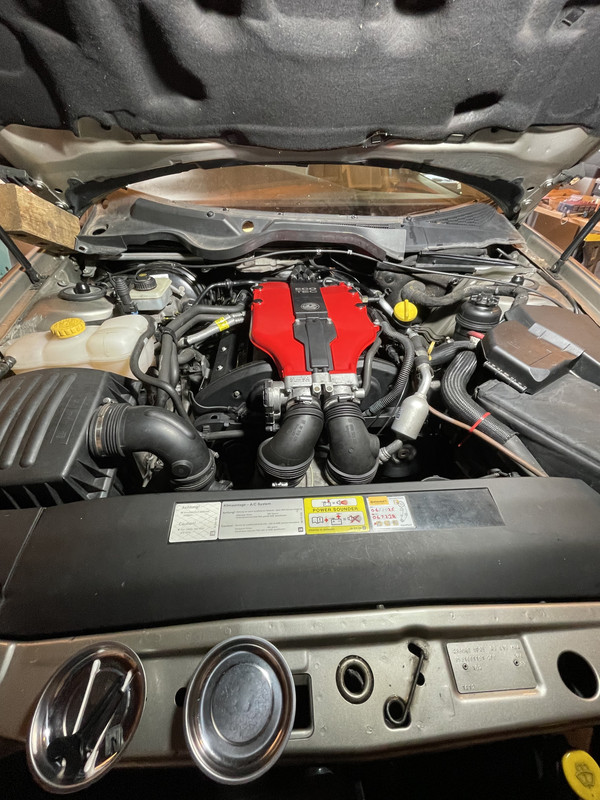

Thanks for your input again.
I took the general advice and ignored the lines. As everyone said, after a couple of turns they’re pretty useless anyway.
So as I say, I locked the crank bang on, wedged, ran the belt to 3&4, used the gauge to get it accurate, then aligned 1&2 on the gauge, using the upper idler to bring them into line.
Couple of turns, then adjusted again, reset the tensioner and turned again.
Every rotation test since then (about 4 I think) has brought the alignment back accurately.
No nasty noises on the rotations either…
Everything’s going back together now.

IT’S ALIVE…!!!
Huge thanks to everyone for helping me through this.
Tried with no fuel and sounded OK. Fuel pump fuse in and first time!  A bit ticky and smoky but after 10-12 minutes it’s sweet.
