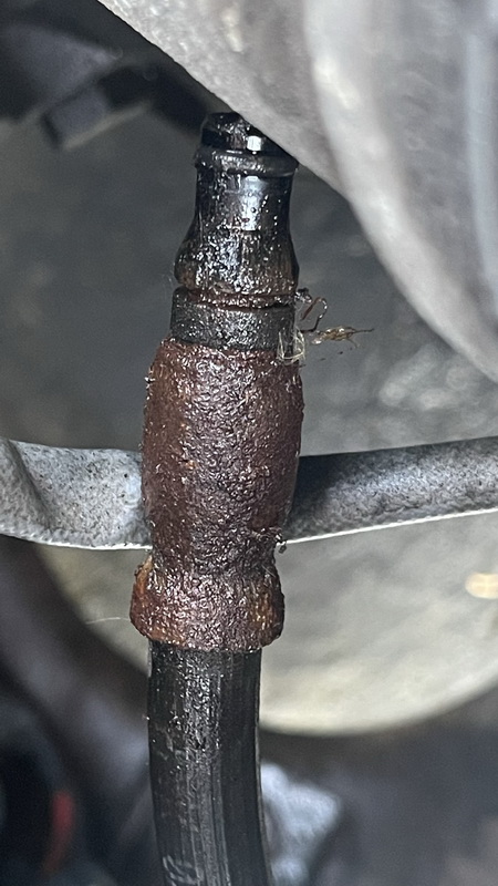

The youngest broke down yesterday, just round the corner helpfully, I was working away less helpfully.
He rang home, by the time the other 2 walked down to him an Ex-Recovery bloke on a motorbike had stopped to help him, diagnosed snapped clutch cable without looking at anything, he started it for him and drove him home with no clutch.  Some nice people out there!

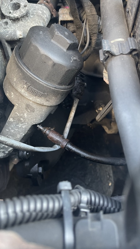

Ive had a very brief look, and could see no signs of any cable, but the car was sat in brake / clutch fluid and I saw this pipe disconnected, looks like some sort of quick connect like a hosepipe fitting.  As you can see, looks a bit grotty, so initially reluctant to just push it back in, and guess it needs replacing.  Anyone aware of anything other than age that would cause that to just pop out, or should I be good to find the other end, disconnect and replace it, any advice, bleeding procedures greatfully received!
Or could / should I be looking at something like this? https://www.ebay.co.uk/itm/388180179042?_skw=clucth+cyliner+pipe+connector+corsa&itmmeta=01JT58KE3X1M3FRC8HS747H6VG&hash=item5a61577862:g:kn4AAOSwOK5n638F&itmprp=enc%3AAQAKAAABAFkggFvd1GGDu0w3yXCmi1dhnpS93anDJyyDXWGN8%2FT%2FXAe1gqo2FcUhN3dnu%2B79843QrDLcoACyRNbq2tRnoTHfwr%2FkU8gfuJ6hnG3sz3JXS9RGi2sxFYT22vqeuHRQy4nhcjpFu0RwPwzIMN8XYfsXUakvvRHtefBPWwqV3cBIyKKaniAjxy7RnKTNt7Eb32I70mA%2BGaD0GnfLtAoFXh%2Bm3%2BCORL9YuILInX05%2BJJh0ooGzDCoxMMv0tsMrVvsEJOG2l85q3eGaE%2B8uAnyO8ztkij1X0Bw6xh6IXBUcGBKsz%2Fmnhb7w1BKZUXHuxFiCiMEnOSLOLiGQCHyyTwWXJg%3D%7Ctkp%3ABk9SR47izajRZQ

Had another look, pipe does fit back, but doesnt lock in place, think my retaining clip may be damaged / part missing, certainly doesnt hold

Yes, pulled it out, ive about 1/3 of a clip!  A round bit with no ends

Was going to say that looks like the feed to the slave cylinder. And that they're usually clipped in place.
The state of that fitting might warrant a new hose, but should be an easy fix and a good excuse for a brake fluid change :y

They are a hydraulic clutch and not a cable  ;D
Looks like part of the pipe has failed, check to see if the plastic part it connects to on the slave cylinder is ok.
A new bit of pipe and clip, plus a quick bleed, should sort it.
The clips are just a standard part circlip type setup, a new one of those may well be enough to sort it

All sorted. New clip fitted. Clutch bled. All good.
