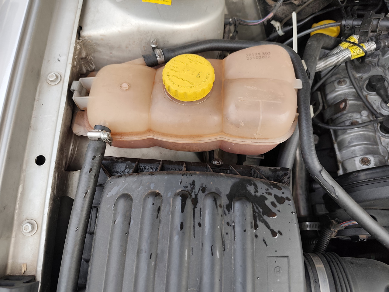

Yes, I will do that and pressure test it, thanks. I'll upload pic of the result of 90 minutes motorway drive from yesterday...It seems like coolant bottle "puked" all over air filter housing. Some thoughts please

Can you tell if it over pressurising?
If it's not, it's either the cap or the bottle looking at that.  Again, using a modified cap allows you to pressure test it all up to safe values (not sure what the release pressure is on the cap, not got one to check - it will be written on it.  Defo keep it well below that figure.
If no leakage when testing, it must be overpresurising, and the cap doing its job and spewing it out.

I think it's overpressurising. See, with old cap, the hoses were really hard and small leak appeared on the weakest point of the system - in my case on the top of radiator where fan switch lives.
With new cap, it seems that pressure releases trough the cap and hoses stay always soft. I'm really afraid of head gasket again, although it was fine for over a year after heads were off.

Just did a sniff test...blue liquid turned green and lot ob bubbling inside liquid....Head gasket failed again only two years after both were done...I'm at a mental crossroad now...
