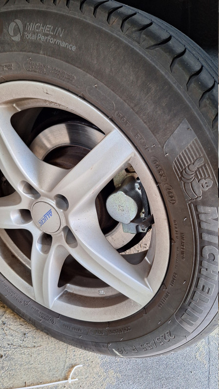

Vented, yes. In a hurry bought new ones.
