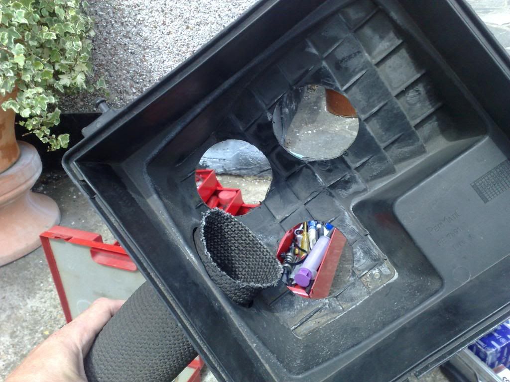

I done what i wanted to do for £10.

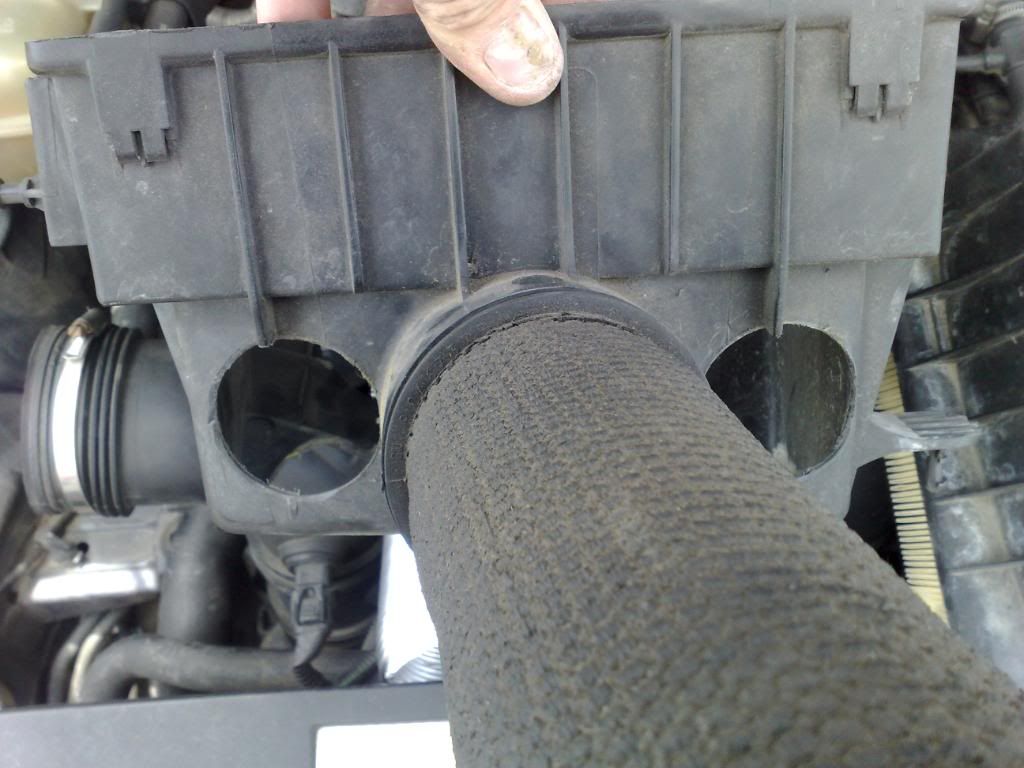

The stock cold air pipe was so long in the box it must have made air flow a little difficult say the least so i cut this back, and drilled some nice large holes in the box for additional cold air.

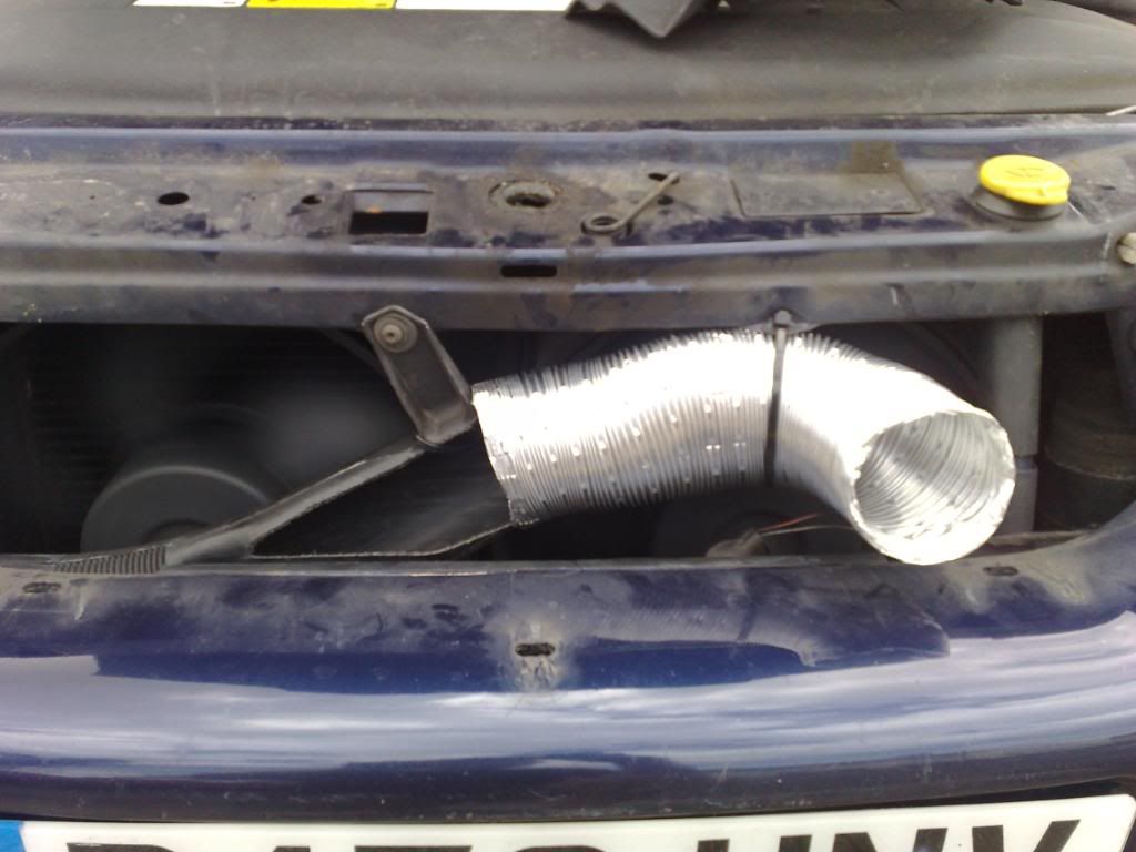

Then as i have no front fog lamps i run 2x 75mm cold air pipes from the fog lamp apperture in the bumper, one to the underside of the inner wing into the exsisting hole, a very nice fit, and the other above the inner wing between that and the headlamp

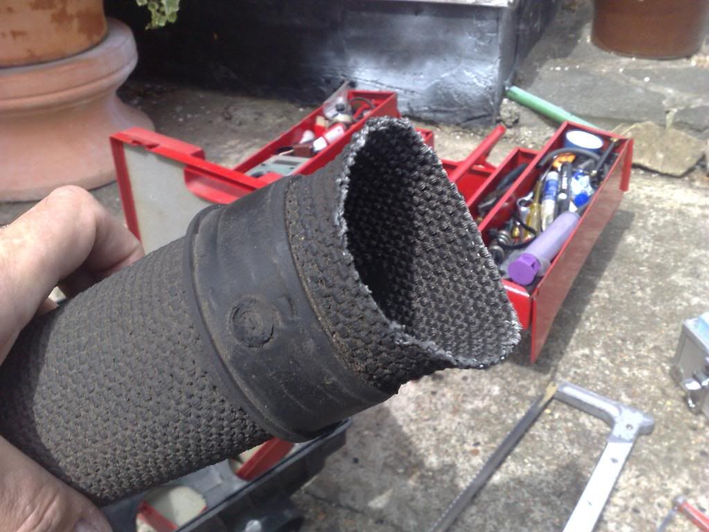

Next i followed the stock cold air pipe and come to the conclusion theres a part missing from behind the grill as it just stopped dead! so i cut a section away to aid air flow into it
Then added another section so it now gathers air from both sides of the grill

I would beg to differ and reckon your missing the same part i am...  the end of the ducting is shaped for something to clip onto it, you can see little fixing tags that would hold another part in place and it terminates in front of the centre badge and at a right angle to the air flow too!!
I would lay money on there being another part to this, if not its a stupid design!!!

The intake is DESIGNED to be at 90 degrees to the radiator ... for a simple reason ... at speed the ram air will strike the front surface of the radiator but this causes resistance and not all the ram air passes though, much will move sideways, so going directly into the "mouth" of the intake, then following a smooth line to the filter box. If the "mouth" was directly forward it would only get ram air which would then have to turn 90 degrees to reach the airbox. By destroying the "mouth" the way you have, you have removed the line from the sideways moving air, and you have no "collector" for any ram air. if it were possible to measure the airflow to your filter IMHO it is now probably less than it was before !!
