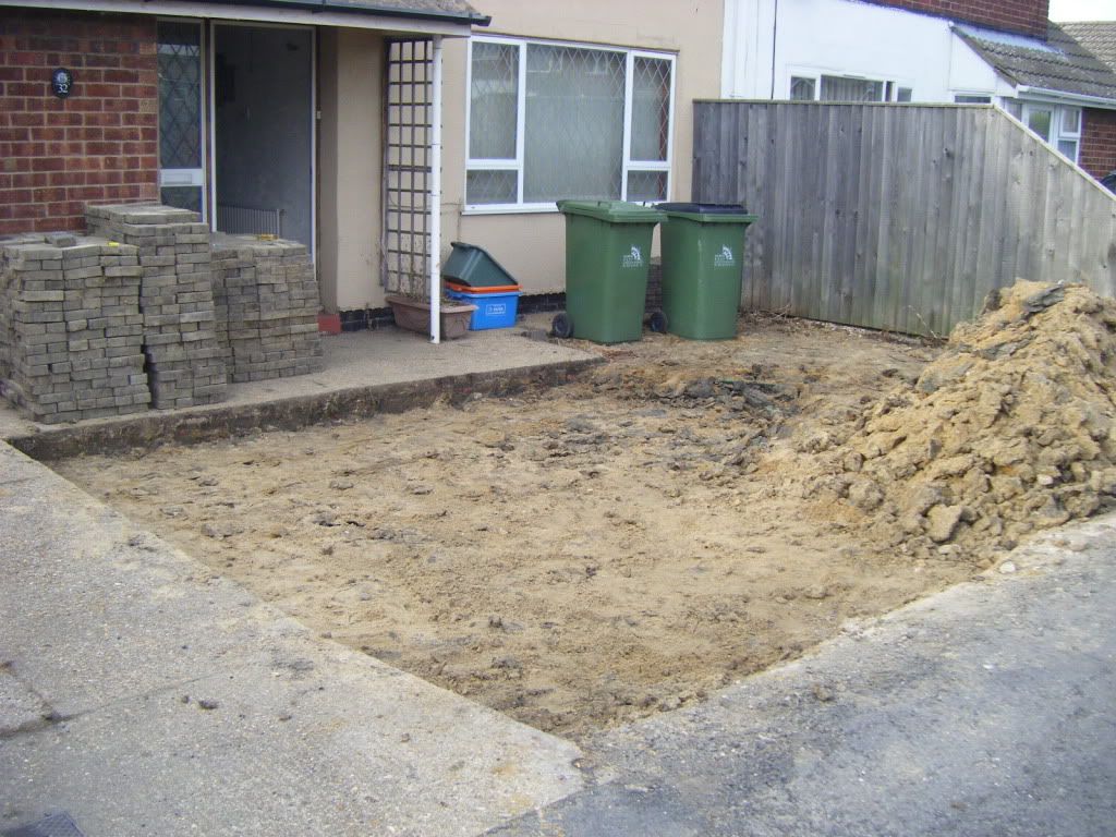

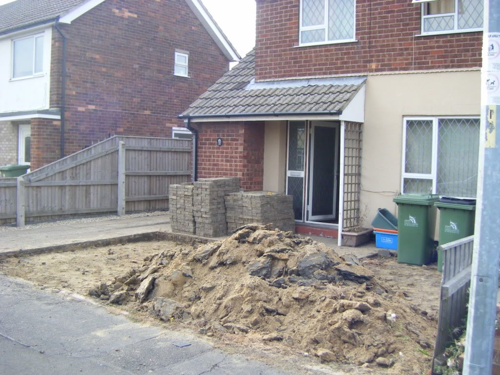

MDTM & many of you know your stuff, i'm aware i'm treading on thin ice but am paying nothing til i'm happy with the end result. As we speak there is someone of Eastern European origin lifting the blocks as we speak.(Poor sod's probably working all Sunday for £20) We've established he likes coffee but does'nt want a bacon sarnie.
    Sounds dodgy i know but will take pics @ each stage.  ::)
Work in progress, compacting & muck away tomorrow ready for stone & sand.
