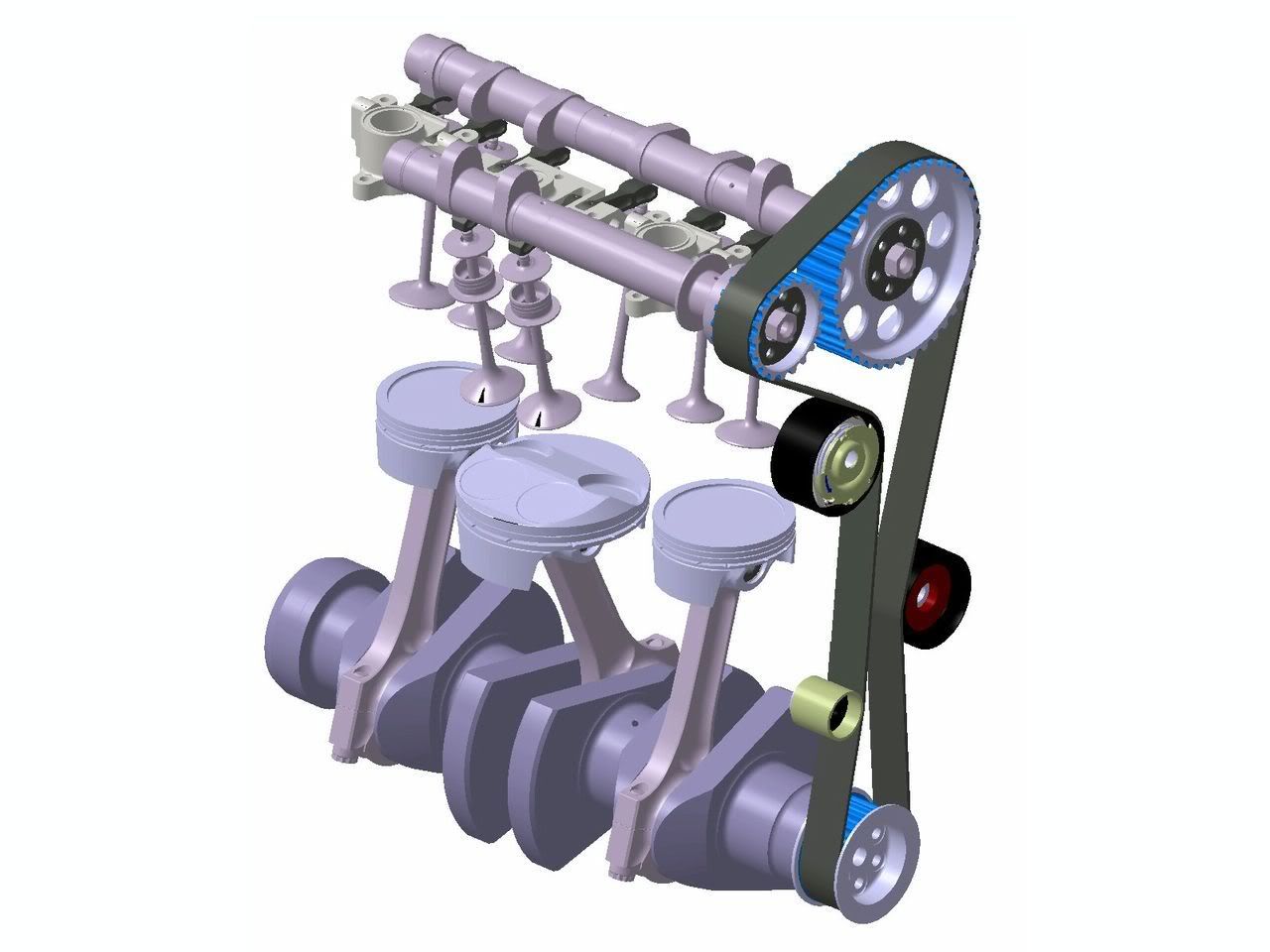

Here is an interesting concept....
« on: 19 October 2009, 14:50:46 »
.....can anybody guess whats special about this engine type?

Surely with differant size cam pullys the valve timing is going to be all over the place :-/

The middle cylinder appears to be designed to act as two cylinders, so maybe it fires twice on the cycle. i.e maybe the firing order would be 1213 or such like. Like a V4 but smaller.

and No.1 and 3 cylinders seem to be missing 2 valves per cylinder,unless its just drawn that way to make it easier to see other details on the drawing. :-/
It looks like one camshaft is going to turn a lot faster than the other,cant think why though,probably something to do with emissions,isnt everything these days. :-/

Quick guess - 2 stroke with compounding

Looks like a 2 stroke and 4 stroke combined :-?

Hmm. I'd be interested to see the manifolds.
Looks like an idea from the age of steam re-hashed if I'm on the right lines...
Either that or the chap who did the valvegear had had one too many.

Variation on a two stroke? Single central piston acts as the crankcase would on a two stroke but the engine doesn't have to run a total loss oiling system and the piston rings don't get chewed up due to transfer ports in the side of the barrel?
Thinking a bit harder.....
The two outer pistons will behave like a (japanese) 4 stroke parallel twin and the big central piston will force charge air into alternate pistons.

Looking at the crank arrangement it alternates between fireing on the two outside cylinders at the same time and firing on the centre cylinder.
I think you're half way there..  :P

This is what it brought to mind for me...
http://en.wikipedia.org/wiki/Steam_engine#Multiple_expansion_engines

Ideas
Cylinder 2 is the compressor, 1 & 3 are the power cylinders
or
Cylinder 1 and 2 are high pressure and cylinder 2 low pressure

Ideas
or
Looking at how the cams are arranged I'd say the latter.  :y

« Reply #13 on: 19 October 2009, 15:20:00 »
Hmm. It's actually rather clever. The efficiency of a high compression ratio, without the losses or the detonation issues.
A 2 stroke wouldnt have a pair of valves per cylinder though. :-/
