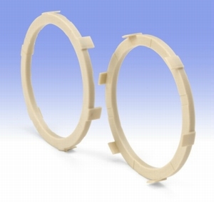

Author Topic: Autobox + Broken Thrust Washer + Engine Size Poll  (Read 3877 times)
ClarCE
  • Newbury, Berks
  • Posts: 735
  • Cam Covers x 5
Autobox + Broken Thrust Washer + Engine Size Poll
« on: 10 April 2007, 09:03:04 »
Please vote as per the question :)
So Far - :: Re-Finished Elite Wheels :: Black Leather Interior :: 3.0 Cams :: Chipped (REMOVED, EBAY SHI*E) :: Facelift Skirts ::
To Do   - :: Facelift Rear Bumper, Door Mouldings :: Irsmsher Front Air Da
rob114
Re: Autobox + Broken Thrust Washer + Engine Size P
« Reply #1 on: 10 April 2007, 09:36:00 »
Yep - one was found in my gearbox sump some weeks ago! 3.0 2000 MV6
The advice I got was if your box has no problems - leave it! Mine is as smooth as a babys bot!
I figure a strip down/rebuild would cost more than a replacement from a breakers - either way if it breaks I will be in the same position albeit inconvenienced with a possible recovery!
Am a little concerned but spose its a calculated risk
I have not held back on the gearbox since finding the thrust washer either!
ClarCE
  • Newbury, Berks
  • Posts: 735
  • Cam Covers x 5
Re: Autobox + Broken Thrust Washer + Engine Size P
« Reply #2 on: 10 April 2007, 11:13:34 »
Yep - one was found in my gearbox sump some weeks ago! 3.0 2000 MV6
The advice I got was if your box has no problems - leave it! Mine is as smooth as a babys bot!
I figure a strip down/rebuild would cost more than a replacement from a breakers - either way if it breaks I will be in the same position albeit inconvenienced with a possible recovery!
Am a little concerned but spose its a calculated risk
I have not held back on the gearbox since finding the thrust washer either!
I actually have a 2.5, and when I took the sumps off there was nothing - then I took the sumps off my doner 3.0 litre box and guess what I found  :o  ::)
I want to see if there is a trend with this, and whether it is more apparant on the 3.0L's - Its odd, and it just seems to keep cropping up more and more on the forum.
Not only that but there are conflicting views, some people say it doesn't matter and like your box, carrys on regardless - other people say its the beginning of the end - however I haven't yet seen a thread where someone has had major autobox probs, stripped it and subsequently found these thrust washers, or at least bits thereof..
So Far - :: Re-Finished Elite Wheels :: Black Leather Interior :: 3.0 Cams :: Chipped (REMOVED, EBAY SHI*E) :: Facelift Skirts ::
To Do   - :: Facelift Rear Bumper, Door Mouldings :: Irsmsher Front Air Da
ClarCE
  • Newbury, Berks
  • Posts: 735
  • Cam Covers x 5
Re: Autobox + Broken Thrust Washer + Engine Size P
« Reply #3 on: 11 April 2007, 09:40:19 »
Please, please vote if you can! 8 votes aint really cutting it!!!
I've added an option if this vote doesn't apply to you.
For those that are wondering what this is, bits of something like this:
Have been found, normally in the small sump on the bottom of the autobox.
Cheers,
Chris.
So Far - :: Re-Finished Elite Wheels :: Black Leather Interior :: 3.0 Cams :: Chipped (REMOVED, EBAY SHI*E) :: Facelift Skirts ::
To Do   - :: Facelift Rear Bumper, Door Mouldings :: Irsmsher Front Air Da
  • Posts: 39981
Re: Autobox + Broken Thrust Washer + Engine Size P
« Reply #4 on: 11 April 2007, 19:02:50 »
Have been found, normally in the small sump on the bottom of the autobox.
Cheers,
Chris.
I'm ashamed to say that although I bought the gaskets & filter months ago, they are still sat on the rear parcel shelf of my car!  :-[ I will do it though, and keep a look out for bits of plastic washer.
Markjay
  • London
  • Posts: 5417
Re: Autobox + Broken Thrust Washer + Engine Size P
« Reply #5 on: 11 April 2007, 19:11:10 »
Have been found, normally in the small sump on the bottom of the autobox.
Cheers,
Chris.
I'm ashamed to say that although I bought the gaskets & filter months ago, they are still sat on the rear parcel shelf of my car!  :-[ I will do it though, and keep a look out for bits of plastic washer.
Same here...  :-[
But then my excuse is that the stuff stinks like hell!  ;D
Besides, I did the comcovers this weekend...  :y
Alas, no more Omegas....
Markjay
  • London
  • Posts: 5417
Re: Autobox + Broken Thrust Washer + Engine Size P
« Reply #6 on: 11 April 2007, 19:12:20 »
The thrust-washer-conspiracy-theory team is leading two-one…
« Last Edit: 11 April 2007, 19:12:40 by markjay »
Alas, no more Omegas....
ClarCE
  • Newbury, Berks
  • Posts: 735
  • Cam Covers x 5
Re: Autobox + Broken Thrust Washer + Engine Size P
« Reply #7 on: 12 April 2007, 12:04:28 »
Well this has been a bit of a flop to be honest - doesn't look like many have taken the sumps off, I'm guessing this is because rather than clean filters people have been just checking the gearbox level - or just not doing any maintenance on them!
So I would say this doesn't really confirm much - anyone know if cornishtaz had a 3.0 or a 2.5?
Cheers
Chris.
So Far - :: Re-Finished Elite Wheels :: Black Leather Interior :: 3.0 Cams :: Chipped (REMOVED, EBAY SHI*E) :: Facelift Skirts ::
To Do   - :: Facelift Rear Bumper, Door Mouldings :: Irsmsher Front Air Da
  • Posts: 24582
Re: Autobox + Broken Thrust Washer + Engine Size P
« Reply #8 on: 12 April 2007, 12:11:28 »
If anyone wants to come and overhaul my gearbox, purely for the statistical reasons, then that is fine by me
 8-)
ClarCE
  • Newbury, Berks
  • Posts: 735
  • Cam Covers x 5
Re: Autobox + Broken Thrust Washer + Engine Size P
« Reply #9 on: 12 April 2007, 18:06:08 »
If anyone wants to come and overhaul my gearbox, purely for the statistical reasons, then that is fine by me
 8-)
 ;D
If you weren't a million miles away I'd do it, feel free to drive down here and I'll change it for you (but won't be held responsible for any tears if theres thrust washer bits in the small sump  ;) )
So Far - :: Re-Finished Elite Wheels :: Black Leather Interior :: 3.0 Cams :: Chipped (REMOVED, EBAY SHI*E) :: Facelift Skirts ::
To Do   - :: Facelift Rear Bumper, Door Mouldings :: Irsmsher Front Air Da
  • Posts: 24582
Re: Autobox + Broken Thrust Washer + Engine Size P
« Reply #10 on: 13 April 2007, 11:54:16 »
Cheers for that, Ill bear it in mind if I ever decide it needs one :)
ClarCE
  • Newbury, Berks
  • Posts: 735
  • Cam Covers x 5
Re: Autobox + Broken Thrust Washer + Engine Size P
« Reply #11 on: 13 April 2007, 11:55:54 »
Cheers for that, Ill bear it in mind if I ever decide it needs one :)
Better let me work out why mines now leaking  :o  :o  :o before you take me up on said offer  :-X
So Far - :: Re-Finished Elite Wheels :: Black Leather Interior :: 3.0 Cams :: Chipped (REMOVED, EBAY SHI*E) :: Facelift Skirts ::
To Do   - :: Facelift Rear Bumper, Door Mouldings :: Irsmsher Front Air Da
  • Posts: 24582
Re: Autobox + Broken Thrust Washer + Engine Size P
« Reply #12 on: 13 April 2007, 11:58:08 »
Lol, will do
and get those torque values
Cant see it happening in near future though, feels fine to me.
  • Posts: 108062
Re: Autobox + Broken Thrust Washer + Engine Size P
« Reply #13 on: 13 April 2007, 14:50:38 »
Well this has been a bit of a flop to be honest - doesn't look like many have taken the sumps off, I'm guessing this is because rather than clean filters people have been just checking the gearbox level - or just not doing any maintenance on them!
So I would say this doesn't really confirm much - anyone know if cornishtaz had a 3.0 or a 2.5?
Cheers
Chris.
cornishtaz had 3.0l
ClarCE
  • Newbury, Berks
  • Posts: 735
  • Cam Covers x 5
Re: Autobox + Broken Thrust Washer + Engine Size P
« Reply #14 on: 13 April 2007, 14:53:34 »
Well this has been a bit of a flop to be honest - doesn't look like many have taken the sumps off, I'm guessing this is because rather than clean filters people have been just checking the gearbox level - or just not doing any maintenance on them!
So I would say this doesn't really confirm much - anyone know if cornishtaz had a 3.0 or a 2.5?
Cheers
Chris.
cornishtaz had 3.0l
Well thats 3 x yes for the 3.0L and 1 x no for it, and none for the 2.5's - not a big enough sample to extrapolate anything of any use really..
Thanks TB
So Far - :: Re-Finished Elite Wheels :: Black Leather Interior :: 3.0 Cams :: Chipped (REMOVED, EBAY SHI*E) :: Facelift Skirts ::
To Do   - :: Facelift Rear Bumper, Door Mouldings :: Irsmsher Front Air Da
