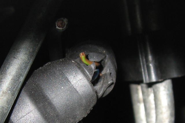

Also, think I may have found the wiring issue with the coolant sensor...

QuoteAlso, think I may have found the wiring issue with the coolant sensor...
Ahhaaa...
humm that does not look good! looks like a clean cut  :-/
Its always possible that the sensor is fubar, and we did this when playing around with it...
I wonder if it had some kind of 'tuning box' POS wired in . . .

still looks like a very clean cut, i don't remember pulling very hard.... sorry if i did break it!  :-[
Thats going to be a bugger to fix, until we can remove the intake.... then it should be ok to solder and fix!
AFAIK that sensor loom does not disconnect and is fixed into the loom at the other end...
Good point.  Maybe one of those stupid coolant sensor resistor things?
Quotestill looks like a very clean cut, i don't remember pulling very hard.... sorry if i did break it!  :-[
No worries, if we broke it when we worked on it, well, we learn by our mistakes.  It is tight around there with intake on.  Though Theolodian has a good point as well  :-/
Did you destroy that plug at scrappies? Thinking of getting it, and soldering in place of my one?
Ermm, i cut it very close to the end of the loom (at engine temp sensor end) It should all be still entact, allthough the sensor loom is 'moulded' into the main loom and cannot be removed.... (as far as i know)
There seams to be a main loom in a box running the length of the block (simialar to the one of the front of my 2.2 with the clip on top)
Might be worth removing that and see how it connects, as for the scrappy TD it should be sill there, just cut off very close to the loom connector...
Before I do a 30m round trip, is there enough wire left on connectot to solder to?  It is one piece of wire back to ECU (well, within 4" of ECU ;))
ermmm i doubt it, i cut the connector off too thinking about it, so who sod knows were it would be in the bay  :-[
The connector was in quite a bad state anyway... covered in oil.
The only thing that would be left is the bare wire that would have gone to the connector, which then goes into the main loom.
Its not worth risking the scappy one i think, need to fix your one!

Not quite sure of access to that cut wire but it looks easily solderable to me. I would tidy up the hole in the rubber boot (ie make it bigger) then solder one end of a patch wire to the cut end, slide over some heatshrink then solder onto the other end.
