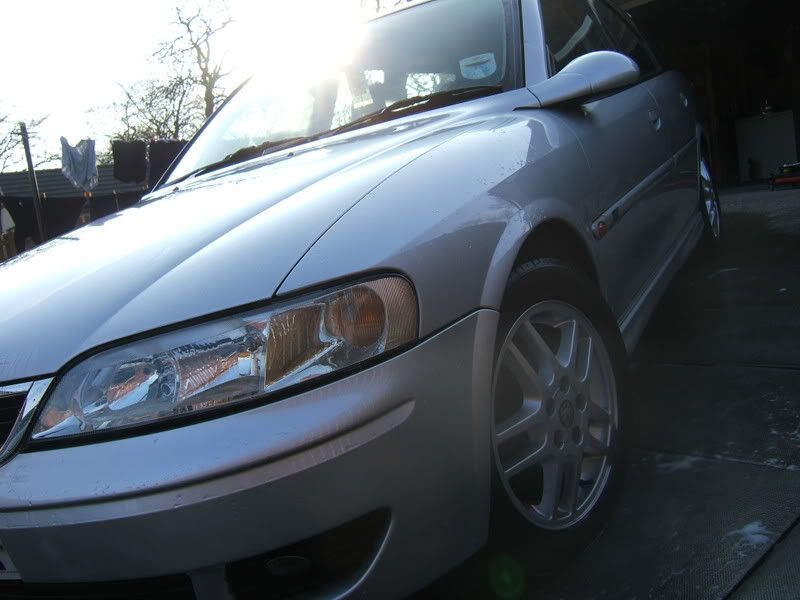

here she is all polished and spending her first night out this year

seriously, that car is too nice to ruin because it's got the wrong cambelt kit on!!
Please, pleasee treat it to a new cambelt kit!
Markie
Quoteseriously, that car is too nice to ruin because it's got the wrong cambelt kit on!!
i will, i am  :y i may keep that car  :-/
But i have no way of doing it where it is and it wont be driven apart from garage - untill its done....
