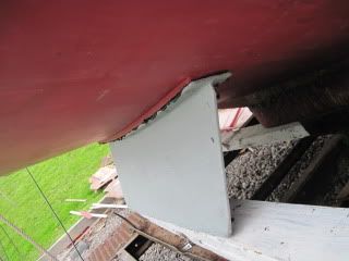

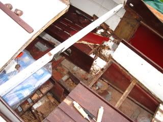

Update on Jenaline IV for those interested
« Reply #7 on: 26 September 2010, 17:41:56 »
Update on Jenaline IV for those interested:
A thorough investigation of the bulkheads unveiled a lot more rot than first thought.  I think the seller deliberately didnt let on about the extent of the rot as there is evidence that someone tried to repair a patch in one bulkhead.
Took off one of the bilge keels and sanded it down, repainted with zinc galvanic paint and bolted back on with some sikaflex.  Tried to take off the other keel and most of the bolts snapped off they were that corroded, 3 will have to be chiselled off/drilled out.  Some of the bolts are 50% the diametre they used to be.
the new keel:
The where the bulkhead used to be:
A better view:
The old bulkhead removed:
The biggest problem I am going to have to deal with is there is a stringer of wood with goes from front to back under the side deck and the coach house which is rotten in places.  I am going to have to replace it but I hope without reoving the decks and coach house in the process.
